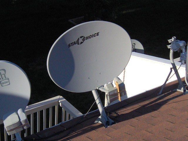

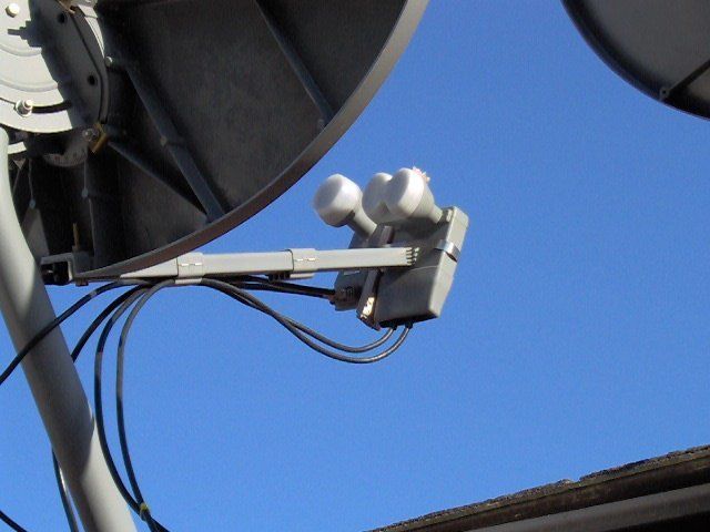

What is interesting is your 119 LNB is on your Star Choice dish, almost touching the Star Choice LNBs, whereas my 119 LNB is on my dish pointed at G10R, and is also almost touching the G10R LNB! Looking at where my Star Choice dish is pointed, compared to my G10R dish, you wouldn't think it was possible that they both could get the same signal and the LNBs be so close to the centre of the dish. Just goes to show you how precise and small the angles can be that we are aiming at, no wonder it can be a pain to find signals!
There is a piece of wood between the SC LNB's and the 119 LNB. Board is probably 1/2-3/4" thick.
Maxes out most of the TP's on the Dish 5000 receiver

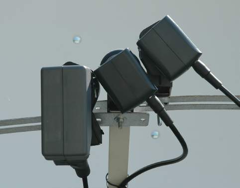

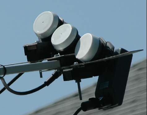

Vacosta said:
I would like to set up my G10 dish with a 2nd lnb for I7. Any photos of your multiple lnb setup for dishes pointed at G10 would be appreciated. Or if somebody knows of another post that has this? THX.
Front and side view. The LNB holders for the extra LNBs are at a slightly different angle than the one that came with the dish. Had to use spacers to adjust LNBs up/down to get best signal. Both IA7 and EchoStar 7 have SQ in the high 70's/low 80's.

Thanks. I am still debating whether or not to make some shorter brackets, since the LNBs are so close to the main one. I can see some big bird thinking it would be a great place to perch and peck at the LNBs! But I may just leave it alone, don't want to mess up what is working so well!
