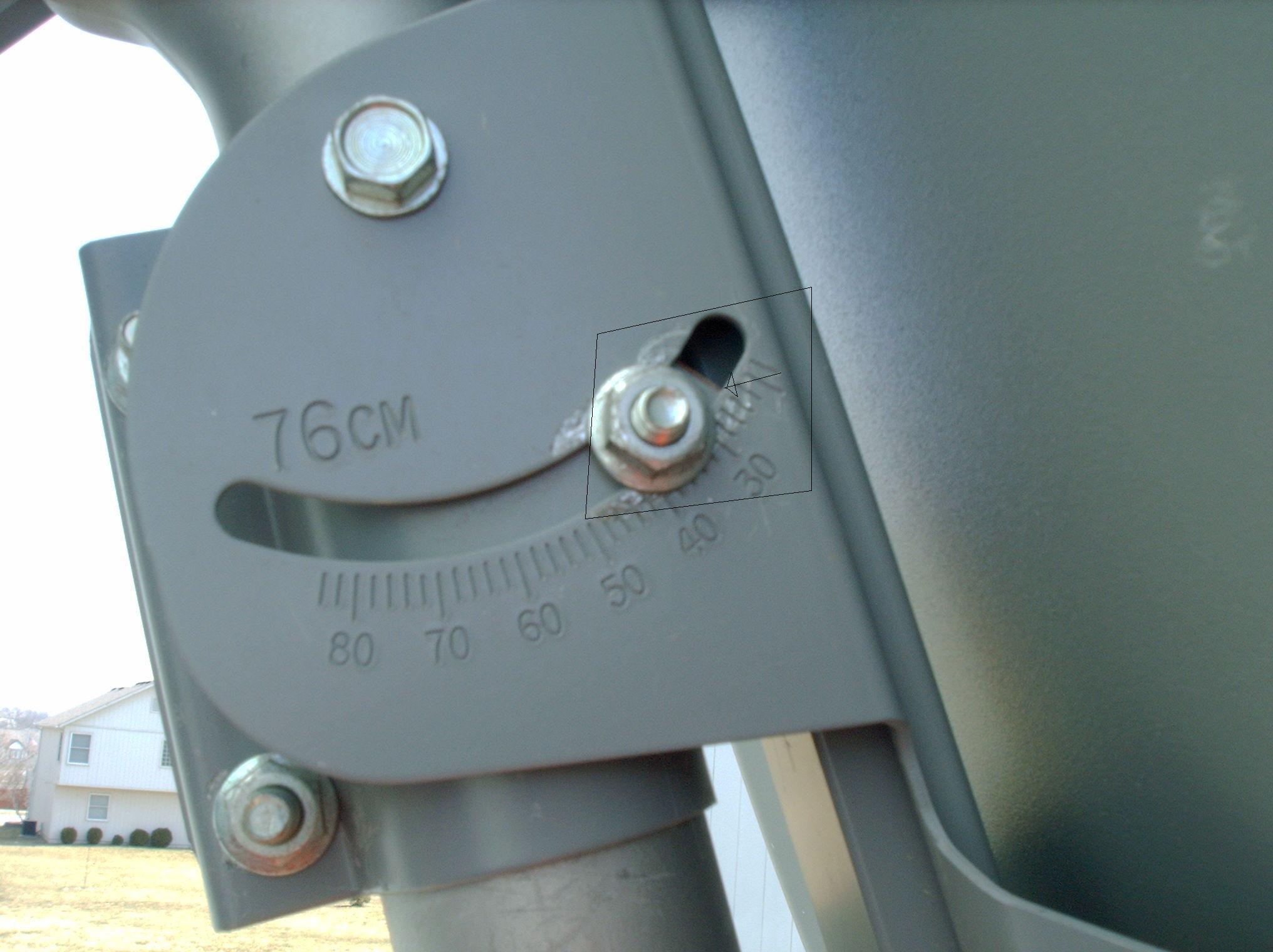

Okay, I've started to install my dish but had a stupid question. How do you read the elevation on a Winegard dish?
Thanks
Use the red line!
Thanks PSB,
That's where I thought I was supposed to set the elevation. For some reason, my dish doesn't have a red line.
It does but it can be tricky to see - look staight at the bracket and it will be at the right of the bolt inside the track that the bolt uses to travel...
Maybe the picture will help you - if you enlarge it you can easily see that I have placed an arrow on the red line.
Thanks for the picture, Pilot.
I went out to look at the dish in the spot you have indicated in the picture and there is not any red mark. I wonder if the 1 meter dish just doesn't have it. Oh well, I think I have set the elevation properly anyway.
I just found out why my dish is pointed incorrectly. I finally called Winegard and talked to a tech who said that the red line is only on their 30" dish. For the 1 meter, he said to read the elevation at the center of the bolt. Just thought you might want to know. It's time for Round 4 with my setup. Hopefully I'll win this one.
