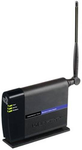

If beyond a reasonable length of a CAT5 cable, then I have this game adapter which wirelessly connects the S9 to the wifi router. It's surprising how often I edit data. Probably because I like looking for DN ITC stations and editing of PIDs must be done remotely with an S9.
