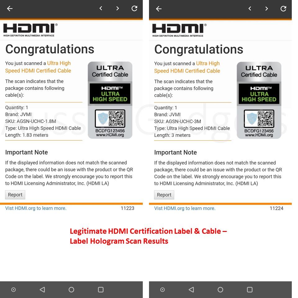

DITTO! (just posted about this here). I have used Monoprice cables for ages and they were the first to really push HDMI Certified and Holographically labeled cables. But they also have "uncertified" cabling that is touted in the description as certified. Make sure the cable has the Holographic Certification label.
or the below QR Scan return:
Thanks for the tip Charles - The cable used is a Monoprice product #15428 - which is Certified Premium. Between this and the DishAnywhere tablet issues over the past few months (now 99% resolved) I had about had it... Everything's working again - until they break it.
