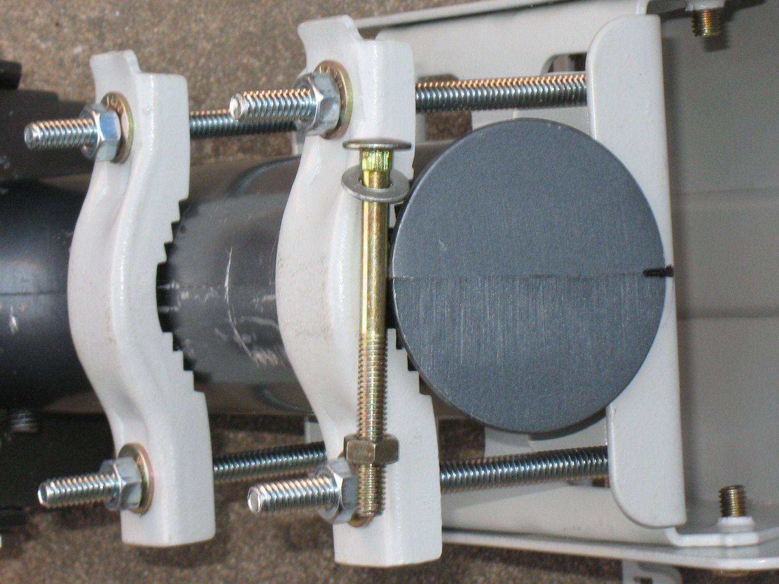

TryingMyBest, thanks for putting up those pictures because I looked at them and There is one Mistake there! The LNBF holder is in the wrong spot, it should be on the end of the arm NOT on top of the arm. So the LNBF is not on the sweet spot of the dish. You need to remove the bolt and then slide it onto the end of the arm just below were it set now.
But everything looks good on your set up and remember relax and take your time and you will get it right.

First off, Musher was right. Your LNB bracket is mounted in the wrong position. (Good eyes Musher.) If you will look at the attached picture, the LNB bracket should be mounted in front of the arm instead of on top of it. If you move this it may solve all of your problems. I would try this before disassembling your motor from your dish. From your pictures it looks like everything is set up right except for the LNB bracket.

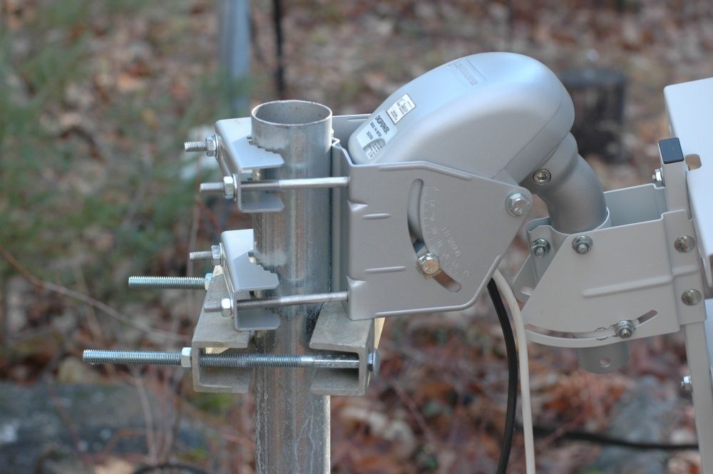

I looked at the pictures you posted. My first impression is WOW, that SG2100 is REALLY different from mine, particularly with respect to the mount that holds it, and where the screw holes are, etc (see below)
The second thing, however, is that I'd really suggest that you check out the angles on that motor with an inclinometer or protractor or something. When I look at the pictures, I see that you're lining up what looks like pointers in the slot to the latitude or elevation angles, setting that on 33/57, however when I try to measure the angle on your picture, it sure looks to me like the actual angles are more like 42/48 instead. Perhaps this is just an optical illusion, but it sure looks to be closer to 45 than to 33/57. Anyway, I'd suggest measuring the angle of that line where the motor case separates. It should be ~ 33 relative to vertical or 57 relative to horizontal.
On MY SG2100, the angle indicator is actually on a prong on the washer, not on the case body. It sure looks like that pointer is the indicator, but it sure looks like the angle is wrong. Anyway, probably just an optical illusion, but I'd check that out with an inclinometer.
Also http://eskerridge.com/bj/FC90-sg2100.html might be of some help, even though a different model of SG2100.

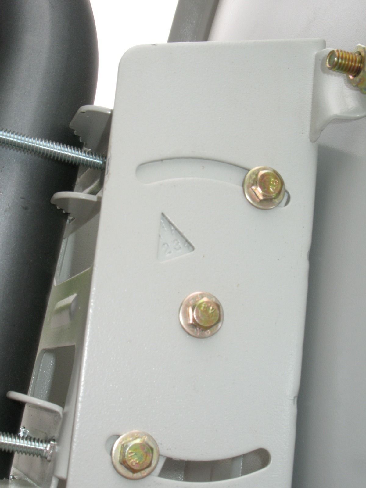

Don't know if this really makes a difference but an assembled dish usually has the dish elevation scale mounted with the scale right side up so it can be read - up is skyward. Check my pics.
I have the same dish, a WS9036, but am using a DG380 motor which has a 35 degree bend. My lat & long are 34n x 118w - not too distant from your location. So my dish elevation would be 35-5.5=29.5 degrees.
The little scale in the triangle shaped cutout reads about 28 degrees after peaking S&Q. There could be some error in that scale because these parts are stamped out in die & punch presses - allow for operator error.lol

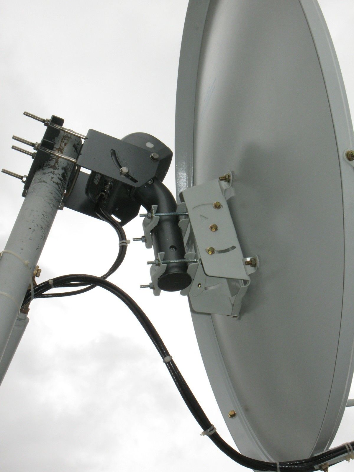

I was looking at your original picture and the others and If am seeing it correctly the holder should be mounted on the front of the dish arm. However, I am not certain as the angle of the mount you have in the original is an exact fit as you have installed it.
That would be something I would check, perhaps you have a new model? I would check that because the lnbf needs to be mounted correctly as pointed out by other posters.
