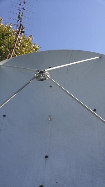

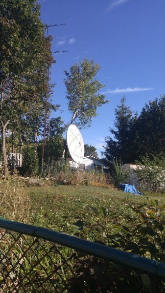

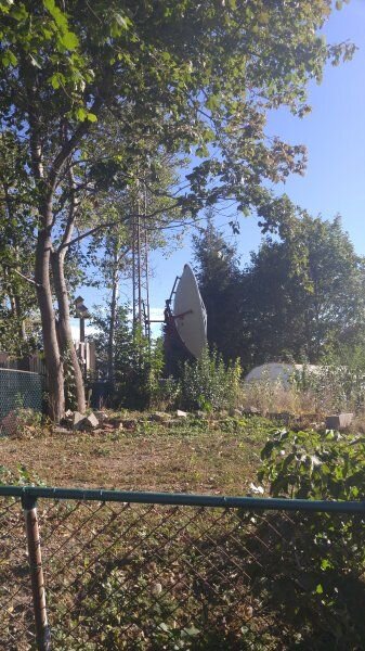

As originally posted in another thread I have rescued another dish from the metal scrappers. The previous owner was going to cut it up and sell it for the scrap aluminum since he thought no one used these things anymore.

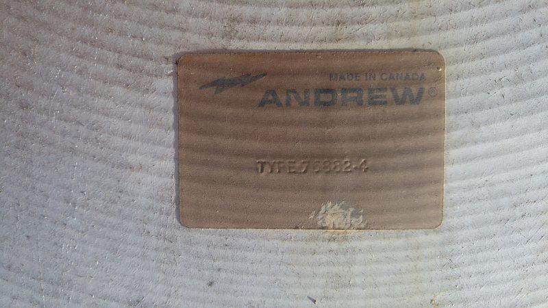

"Operation Rescue 3" was a success and it is now in my possession. It's a real beauty. It's an Andrew Corp. (ASC Signal, now CPI-ASC) 3.0m spun aluminum solid reflector. It's a TVRO model with a very heavy duty polar mount. 20170930_162110.jpg 20170930_162203.jpg 20171022_115930.jpg I think this is the model# 20171022_114207.jpg It looks like Andrew welded two sheets of aluminum together then spun the unit. I can make out a welded seam in it.
The actuator is a old Warner Electric 24" stroke Potentiometer model so I'll just use one of my Von-Wiese units as a replacement.

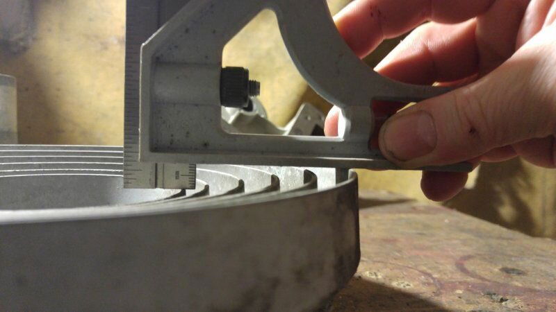

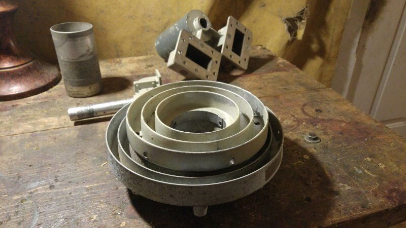

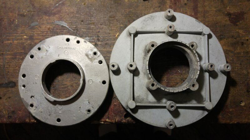

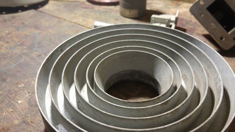

Of particular interest is the factory scalar (luckily still on the dish) 20171030_175248.jpg 20171030_183106.jpg Its much bigger than todays scalars (shown here with a Chaparral on top) 20171030_174749.jpg 20171030_174953.jpg The 6 rings per side are only 12.5mm apart instead of the usual 15-16mm. Also its not entirely a flat scalar. For some reason Andrew made the rings concave 20171030_175124.jpg Titanium do you know why Andrew might have done this? The feed bore diameter is 70mm which is a coincidence because I wanted to use the dish on ku and the outer diameter of an Invacom ADF-120 prime focus feedhorn scalar adf120.jpg is 70mm I think. So it should fit nicely inside the feed bore of the Andrew scalar.
So the plan is to paint the polar mount with grey rust paint. Its a reddish brown color now. Also the reflector will get a good cleaning then on a pole she goes :) It should make for some interesting testing. Since the model # of the dish basically turns up nothing on the internet & I don't have a manual for it I am curious whether it was originally designed to work in both the C&ku bands.

What is the FD ratio? The slight concave shape to scalar might suggest that ratio is high. Having the scalar that was designed specifically for the reflector is mighty fine! Probably much better performance than using a generic flat type.
Hope you will be able to post up some comparisons between the OEM and the Chaparral.

"Operation Rescue 3" was a success and it is now in my possession. It's a real beauty. It's an Andrew Corp. (ASC Signal, now CPI-ASC) 3.0m spun aluminum solid reflector. It's a TVRO model with a very heavy duty polar mount. View attachment 129054 View attachment 129058 View attachment 129060 I think this is the model# View attachment 129059 It looks like Andrew welded two sheets of aluminum together then spun the unit. I can make out a welded seam in it.
Of particular interest is the factory scalar (luckily still on the dish) View attachment 129061 View attachment 129066 Its much bigger than todays scalars (shown here with a Chaparral on top) View attachment 129062 View attachment 129064 The 6 rings per side are only 12.5mm apart instead of the usual 15-16mm. Also its not entirely a flat scalar. For some reason Andrew made the rings concave View attachment 129063 Titanium do you know why Andrew might have done this? The feed bore diameter is 70mm which is a coincidence because I wanted to use the dish on ku and the outer diameter of an Invacom ADF-120 prime focus feedhorn scalar View attachment 129065 is 70mm I think. So it should fit nicely inside the feed bore of the Andrew scalar.

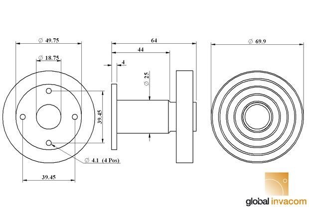

It's 0.30 from my rough math. 122" Dia 25" depth. It's definitely a deep dish. Very similar to my Pinnacle. Since the Invacom is only from 0.32 f/d I might have to get it machined for slightly more to match the dish 0.3.

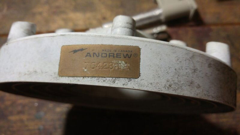

Thanks for the info. I want to email them to see if they have any manuals or sales brochures. One thing missing off the dish is the big red lightning bolt logo (ASC's TM). Maybe they'll have a decal for a modest fee.
It's hard to find information on anything these days because everyone has been bought out by someone else. It looks like Andrew has changed hands at least 3 times since they began operations. Each time it changes hands, it gets more difficult to find information on products offered by the former company. I was lucky enough to find a website that has master reset passwords for just about every satellite receiver ever made. I expect it to disappear one of these days.

Just thought I'd share the latest info on my rescued 3.0M Andrew dish. Thanks to the generosity of fellow member pacificrim I now have the proper factory feed-throat to go with the scalar. It looks like this (minus the LNBS). IMG_20180526_41965.jpg So they used a one inch thick bit of Styrofoam to plug the throat. It looks just like the blue stuff used to insulate outside walls. 20180611_132200.jpg 20180611_141728.jpg I cut it out and want to use a plastic cap I have from an old LNBF. The blue chaparral cover doesn't fit over the thoat cause the throat is too wide. 20180612_175630.jpg 20180612_175728.jpg Its a nice snug fit.
So the feed is a solid piece of square aluminum machined out. They use what look like thin aluminum rods to convert the circular RF signal to linear RF signal for the LNB. 20180611_141247.jpg 20180611_132400.jpg And some sort of aluminum pin maybe to act as a tuned frequency cavity? 20180611_141231.jpg
It's interesting that there is such an abrupt ridge about 1/3rd of the way down the throat. It was used to hold the Styrofoam plug in place. I thought abrupt ridges like that were a no-no in a waveguide due to the reflected energy they cause. But since the Andrew engineers probably knew what they were trying to accomplish much better than me I will leave it alone. It's also quite clean inside given it's age. 20180611_141214.jpg
