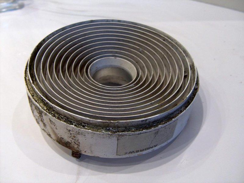

Of particular interest is the factory scalar (luckily still on the dish) View attachment 129061 View attachment 129066 Its much bigger than todays scalars (shown here with a Chaparral on top) View attachment 129062 View attachment 129064 The 6 rings per side are only 12.5mm apart instead of the usual 15-16mm. Also its not entirely a flat scalar. For some reason Andrew made the rings concave View attachment 129063 Titanium do you know why Andrew might have done this? The feed bore diameter is 70mm which is a coincidence because I wanted to use the dish on ku and the outer diameter of an Invacom ADF-120 prime focus feedhorn scalar View attachment 129065 is 70mm I think. So it should fit nicely inside the feed bore of the Andrew scalar.

I think, in KU band the Invacom ADF-120 does not see the entire surface. The situation is the same in "C" band. The Chaparral scalar ring does not see the entire surface. If I had a larger scalar ring would it be better?

What makes you think that the ADF-120 and the Chaparral feeds are not illuminating the entire reflector?
A .3 FD is in the mid range setting for these units.

I've read on a forum, from Eduard Bach, Greenland. "If the dish is deep, this is possible". Then he attached a photo. Maybe this feed horn does not even see the entire surface.
