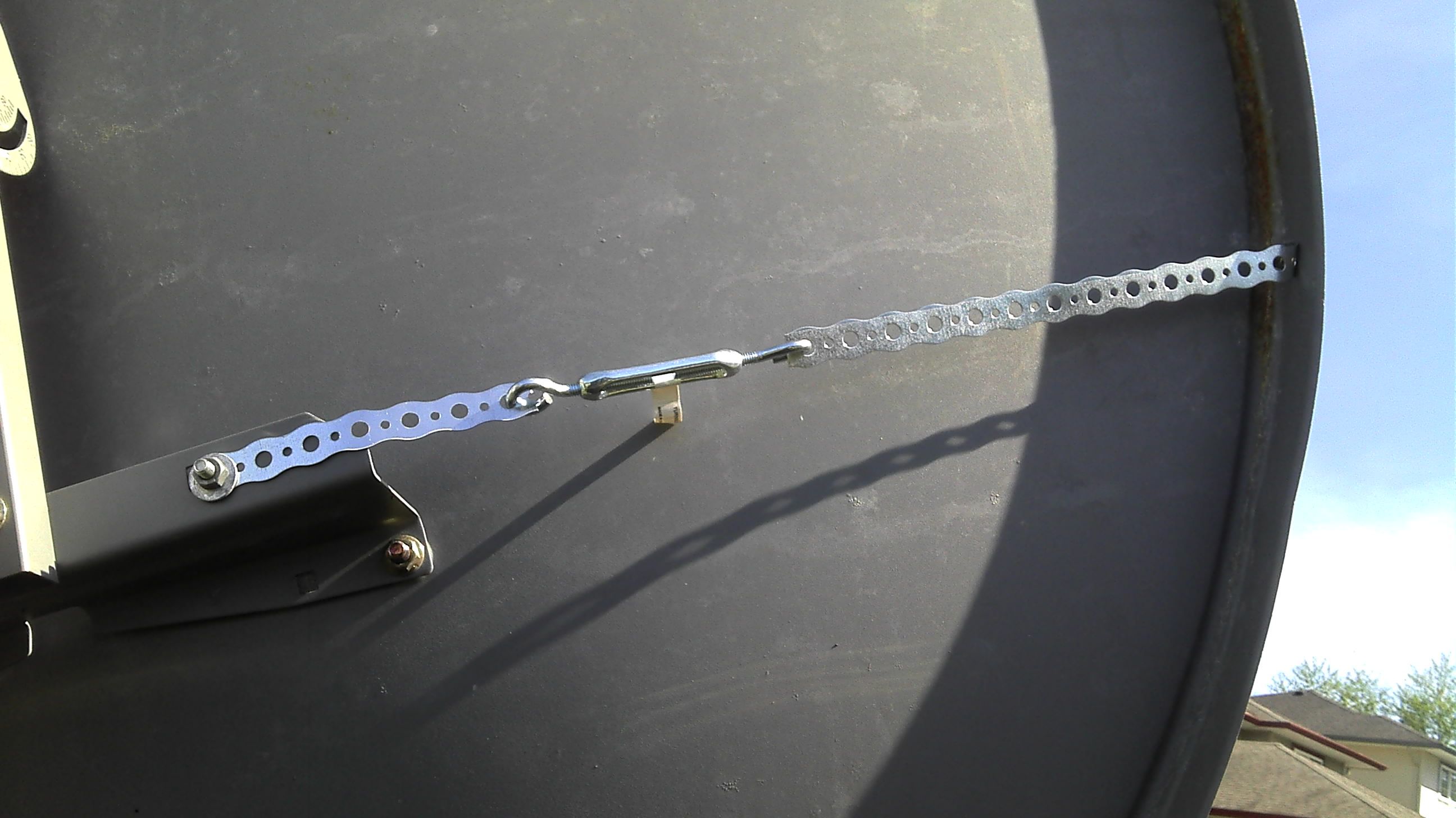

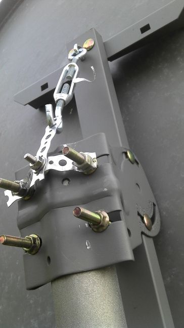

I put two straps and a turnbuckle on each side of the dish to pull in the sides of the dish. The weight of the LNB and the side arms were pulling the dish out of shape. Now I have a cband, ku and ku circular lnb on it and there is no warping or pulling.
The other mod was to add a fine tuning elevation adjustment
They were super cheap and easy mods and made the Fortec 1.2 a good dish.
I also have a 1m Winegard (ex Starchoice). If I had a choice between a 1m Winegard and a 1.2m Fortec - I would (and did) pick the 1.2 Fortec. With the mods I did I get everything on Ku and lots on Cband.
