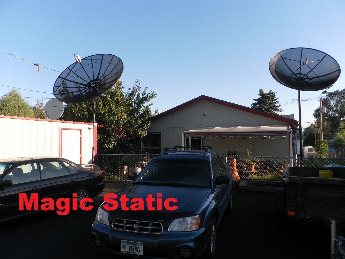

:welcome to the forum Skywave. You might get NHK with a good receiver ok, but like T4Runner said, you won't be satisfied. So unless you can score a 1.2m for free to play with, I wouldn't want to spend a lot of money in the deal. When faced with ground restraints I opted to go up :)
Thanks guys:) T4Runner, I hadn't even considered the DVB S2 issue. A 6 footer should fit, I'll have to go out there and get some accurate measurements and draw it up. I will have to be a little more careful as to the precise location and make sure to get it high enough for the bottom of the larger dish to see over the fence. So yes Magic Static, up is the word. Nice set up, by the way!
