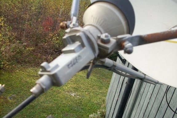

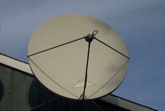

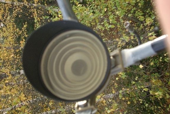

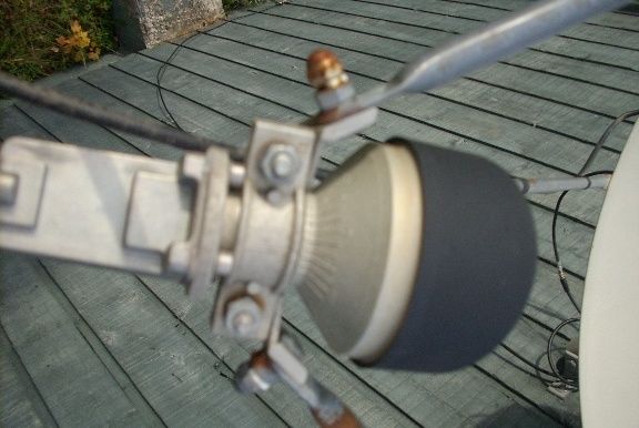

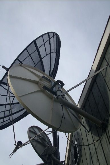

Anole, here's the pictures you where looking for. And Tron, does this look like a single-polarity LMB.

Its hard to tell about the LNB polarity. The feedhorn seems to be standard C-120, and it looks like there MIGHT be a waveguide in there between it and the LNB, which would indicate single polarity. Since most commercial dishes don't use voltage switching LNBs, I would say odds are it is a single polarity LNB.
I think you're right Cavsolutions, it looks like a Prodelin dish. Thanks for the info.
Anole, the only thing on the lnb is Norsat 7000A Series Module GM-6921 11.7-12.2 GHZ and a serial number. As far as the logo goes, it's so faded it's unreadable but I assume it's XM RADIO.
