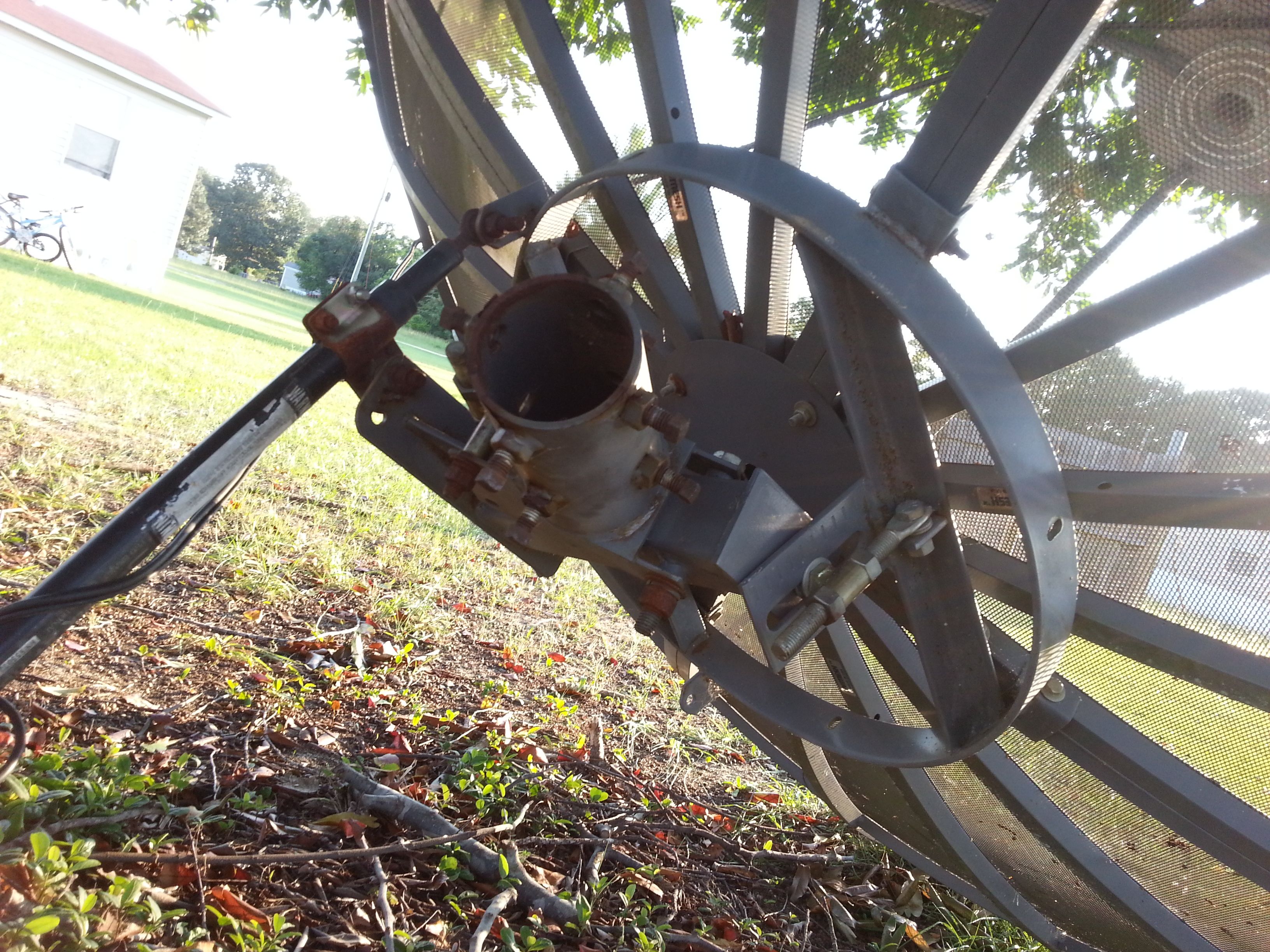

Ok guys. Been a while since i posted . We about to buy our own home. I will be able to set up one of my mesh dishes i have aquired. I have found two 7.5 full dishes with mounts minus the 3.5 pole. Which i have accsess to 3.5 inch post. Also i got back a 10 foot i gave away years ago. My question is can i use one of the 7.5 polar mount on a 10 foot panel. Here is a few pics
ATTACH]
Here is 7.5 polar mount.

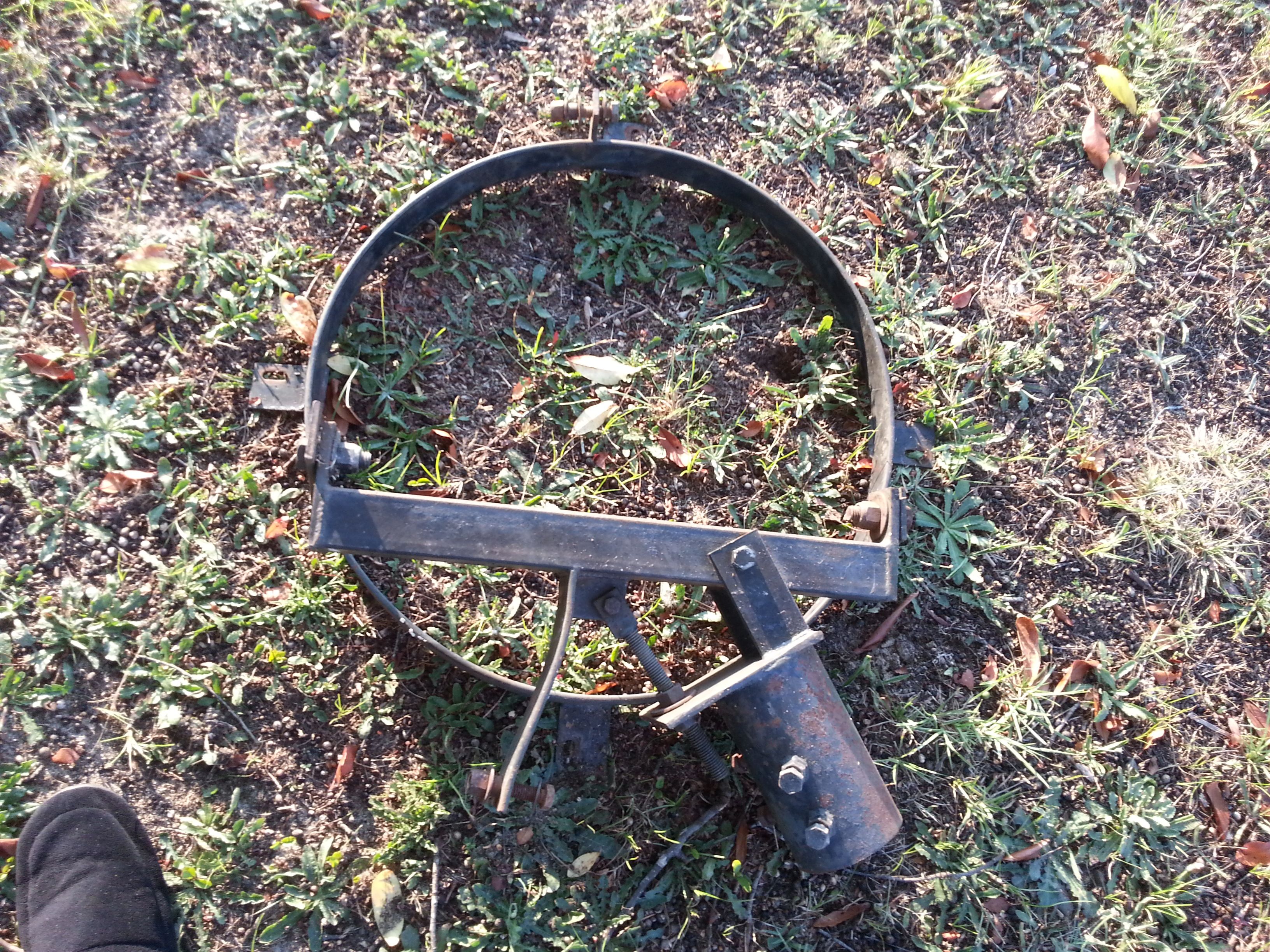

pics.
and second pic is mount i got back from a 10 foot dish i gave away years ago. I think 10 foot mount is missing parts.

Here is mount i got back from the 10 foot dish i gave away years back. I think its missing parts. Question is . Can i use same mount from the 7.5 dish and mount the 10 foot pannels. Here is 10 foot mount.
That old mount looks like the first generation Sami dish mounts, the dish on the first photo is made by Winegard i do not see a problem mounting the 10' dish on it . You will need to drill new side holes on the dish panels so you bolt the 10 footer on the Winegard mount.
