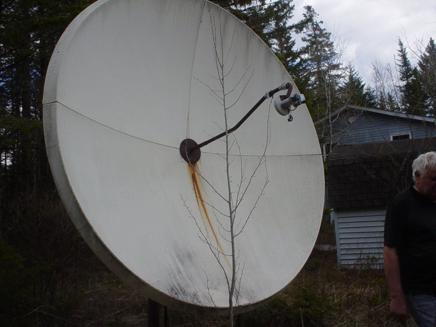

Went to have a look at the dish this afternoon and it looks pretty good. Got some pictures to post.Let me know what you think.

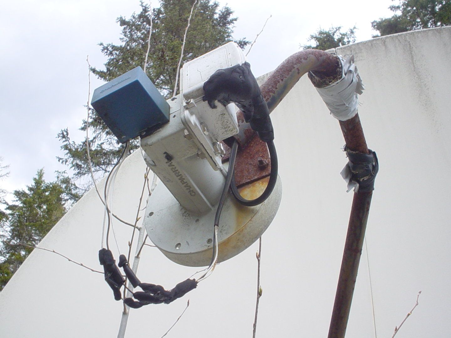

Would the LNB in the second picture still be ok to use?

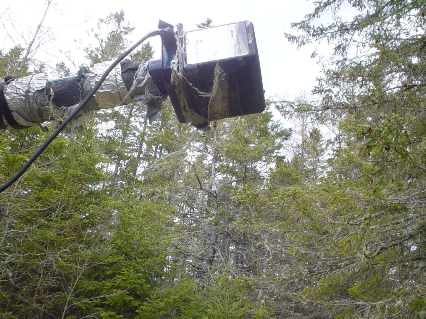

The LNB does not look all that old, so might be ok. But it will require using something that can control the polarization servo ( like the Titanium ASC-1 or an old analog receiver). So in the end you might be better off replacing it with a LNBF that uses voltage to switch polarity.
I would replace that LNB and feedhorn with an LNBF. String test the dish in 4 directions at least to check for warping. I have a fiberglass to install, but I am only bothering because it is perfectly shaped with no warping or cracks.

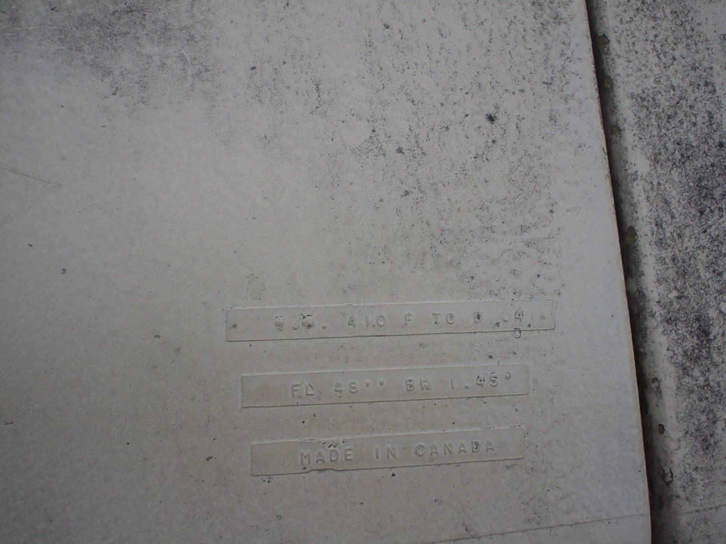

Thanks for posting this, refreshing to see a little-known dish pictured.
Never knew there were dishes made in Canada!
Not sure about the mesh size inside, or accuracy of this, but you must be prepared that this could turn out to be a C-band dish, rather than a general-purpose large dish.

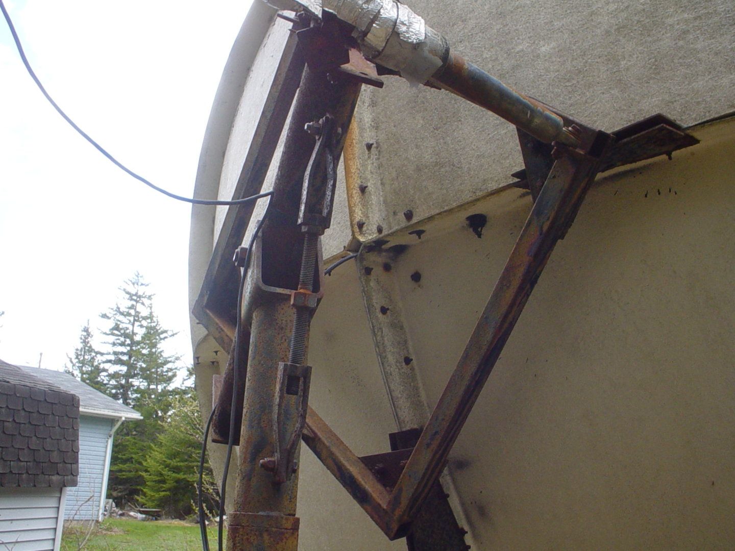

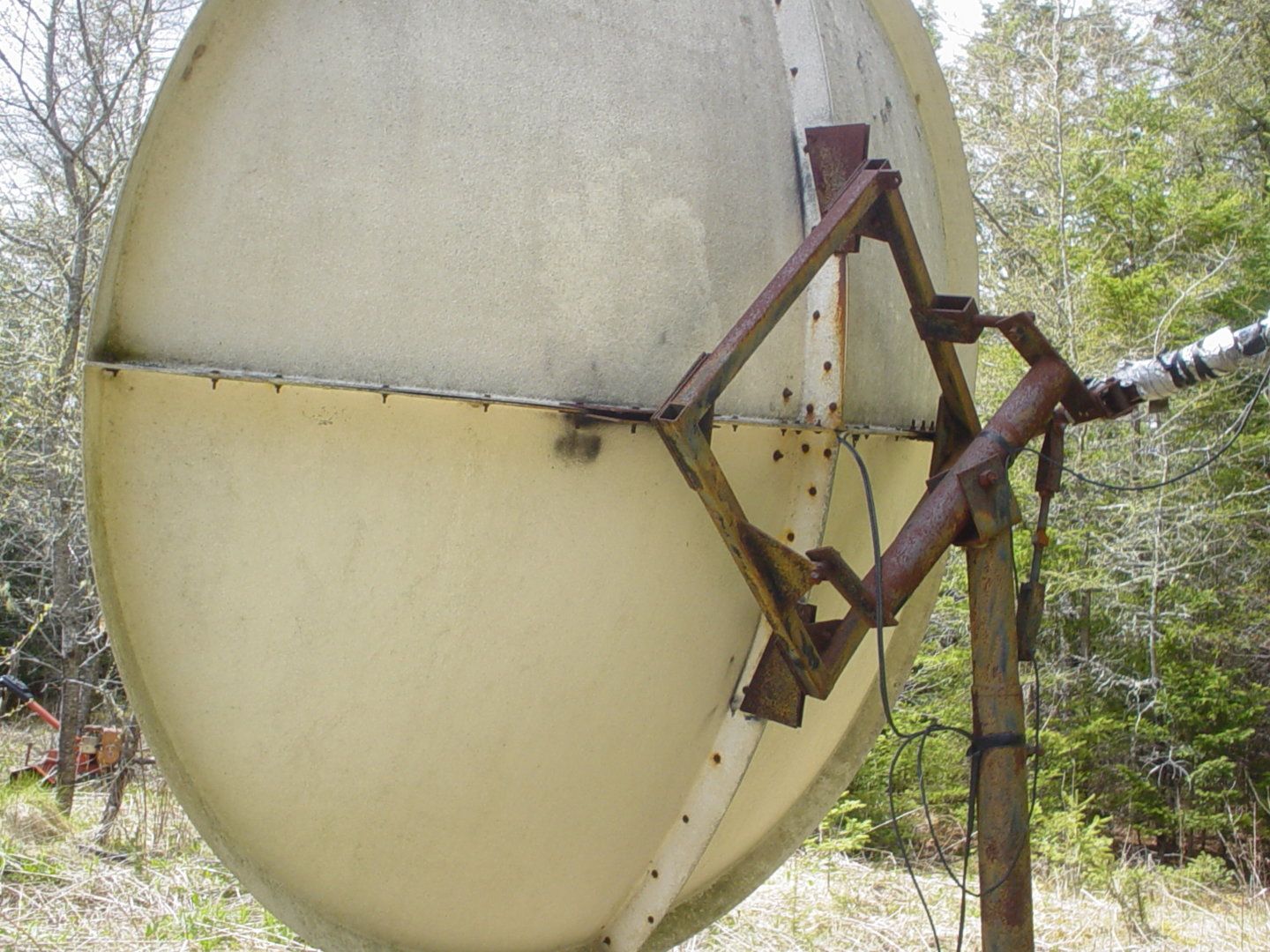

If the latter, I would probably suggest you put some energy into refurbing the polar mount (bushings, bolts), as it looks to be a bit weathered...
Do also consider where you are going to mount this. It will require some concrete or good wall-mounting brackets to make it (not) fly!

Hi st1. I didn't know Canada made satellite dishes.It looks good and sturdy and the surface is still nice and smooth.Needs a good wash to get 30 years of grime off.I also have an aluminium 10 ft dish that I am setting up now that I can use for KU if I want but I haven't really seen much on KU worth watching.
The first thingI would do POWER WASH real good, next take the button hook off of it, and make some quad legs for it, get a new actuator, and bullseye II feed horn and put ku and C band LNB's, if you did that you would have a like new KILLER DISH.
If the button hook is mechanically sound and centered, I would keep it. A button hook mount is typically much easier to set the FD and align the feed with polar axis. While your design doesn't allow, many button hook designs set the FL and skew from behind the reflector by loosening one or two bolts.
