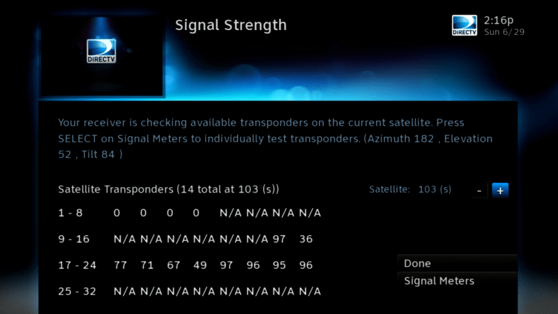

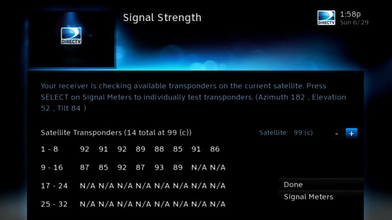

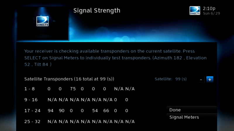

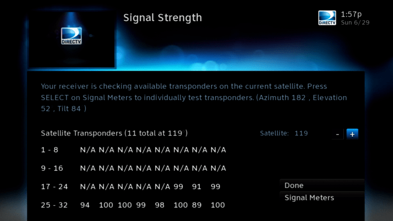

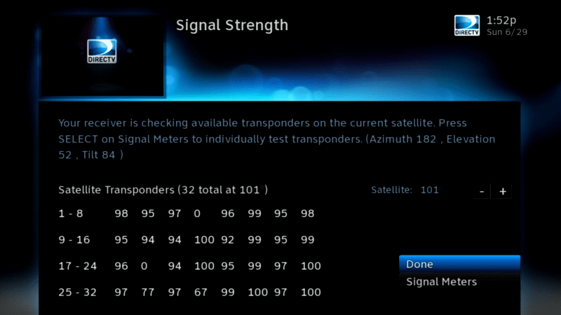

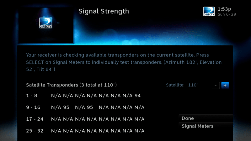

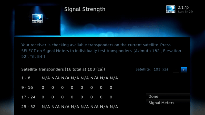

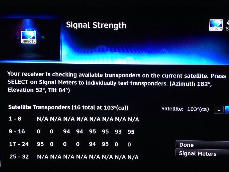

I'm getting all 0's on 103ca but 90's on 103cb and 99ca.
Using NON SWM Slimline 5.

Couldn't it also be a bad cable? Isn't 103ca on one cable only? I don't recall if it's 13v or 18v
It would lose both 103's. 103, 110, 119 is all tied together going in to a switch. I'd say it's an LNB
Could it be the BBC?
Guess I need to test it by removing it, "a" should work without it, "b" won't.

Wow. This is crazy. Look at it now.

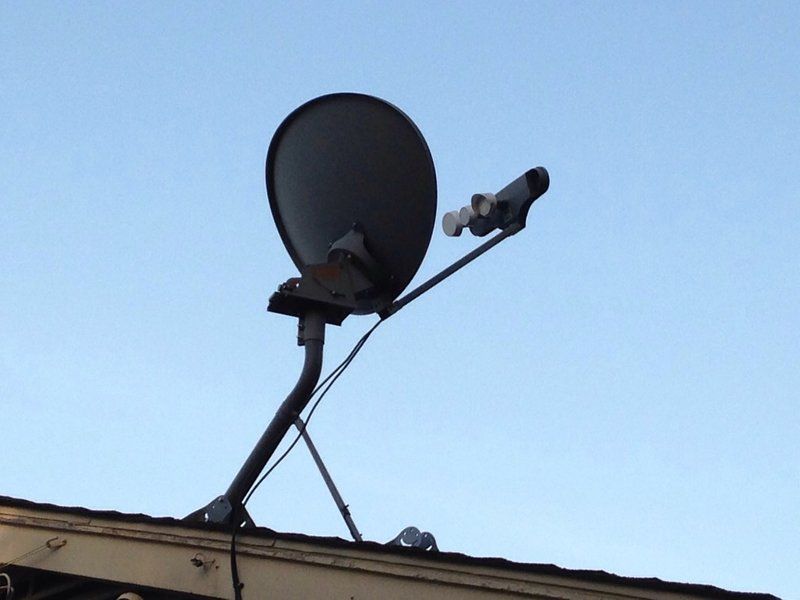

I'm guessing the summer heat is affecting the LNB?
Posted Via The FREE iOS SatelliteGuys Reader App!
Yes, it looks like it....
That's right...I forgot about that...If it's installed on and asphalt shingle roof and it's in direct sunlight and it's hop( over 90) a good part of the day, that LNB is subject to temps as high as 130* or more.
Not good. The indication is intermittent signal loss.
Since the OP has it back, the heat related outage is the ticket
Ya it's your standard roof install.
All is working now that it has cooled down outside.
