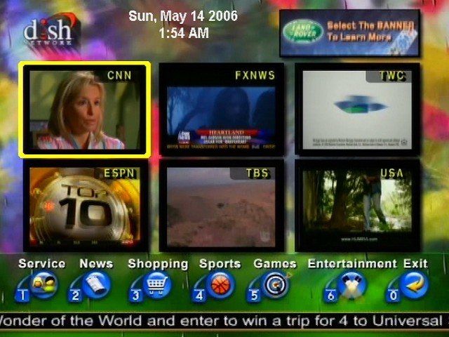

Here is a pic of my Dish Home on the 510 that I just took...
Well, Dish Home works well for me here on my 510. I've never had a problem with that feature. I still have the original problem from thread start regarding the check switch/locking onto 110. I will try and post my info for tech support tomorow as I'm a little short on time today.
If your check switch is wrong Dish home will not show. Once check switch is correct it comes in.
After teh tech had me to run the check switch and it showed 110 even x'd or both 110 x'd dish home would not come in.
I had to unplug the other recievers to get it to pass the check switch and then dish home would work.
