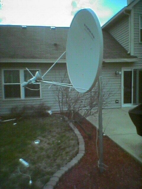

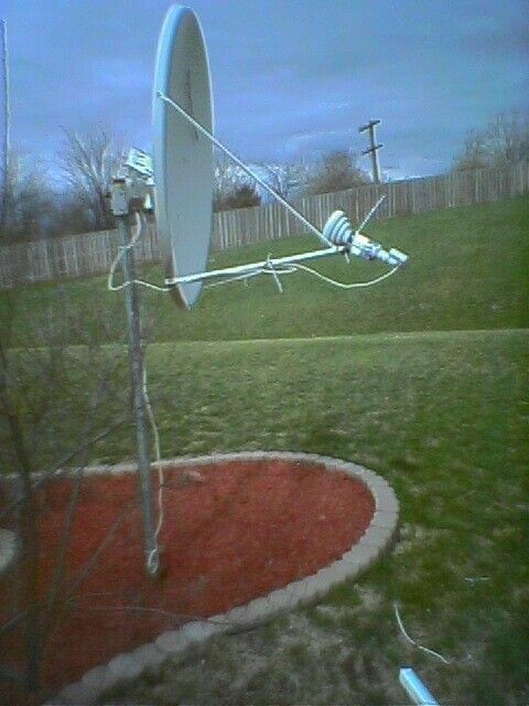

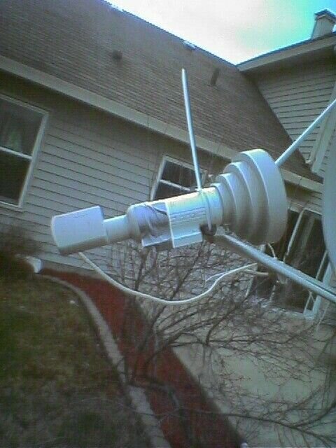

This may be a long shot, but has anyone else tried doing this. I cut open the end of my spare c-band lnbf and duct taped :) my invacom to it. I don't know if it renders the c-band lnb useless (I haven't tried it yet), but my ku reception works just fine. I am on Hispasat right now and I am getting about 75% quality (about 5-10% less than before, but I really didn't do any tweaking, I just put it on there and eyeballed it).
Here are some pics I took with my phone camera (I couldn't find my digital camera so the quality is not that great).

Done. Sorry, once you have fast connection you become ignorant :)
VERY nice! "Alex" a member here from AL. has tried this before, same principle as the CKU LNB I am testing right now!
Great work!
Sadoun said:
nice pictures VJ. Where did you get the scalar cone?
The only place that I could find it was eye in the sky. It came with the Astrotel PM-9/C-V/H Gold lnbf. I think my post when I got it last year is burried somewhere in the middle of this thread. They actually list it as an offset c-band lnbf.
Ok. I saw also an Australian company selling it on the web. How is the setup working for you?

Both of my c-band lnbs are busted. I did fix up one (opened it up and it was full of water). It is a lesser of two (gain/noise wise) and now it is also off in frequencies reported.
With that said, I was able to get a lock on TVU on amc3. Quality was about 40% and breakups every once in a while. I think results would be a little better with a better functioning lnbf.

I had it just sitting there on my dish for 4-5 months unplugged and I think the water got in through the cable connector hole. Just a lesson learned to water proof everything :)
