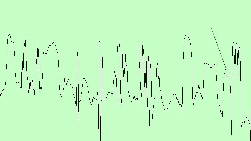

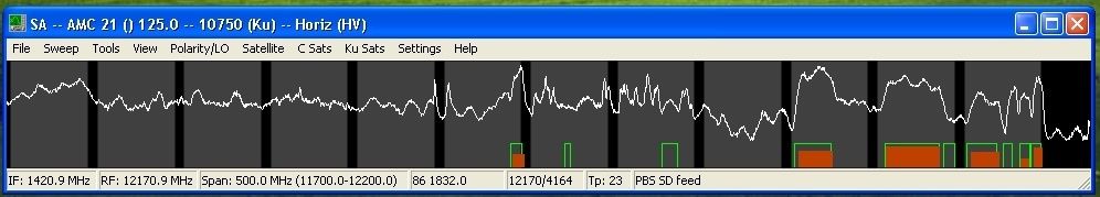

I wonder what's up with the 12150H transponder on AMC-21? I tried to tune it in this morning, and it is about half the signal (over noise floor) of most of the other signals on the sat. It's even half the strength of the 3 SD SCPCs on the same transponder. I'm having a very hard time locking it at all.
I hope that they haven't decided to reduce the power on it to keep us from viewing it.
I guess another possibility, which I've often observed with the SD SCPC signals is that they have multiple uplink facilities for that freq, and that this morning it just happens to be a facility that isn't using as much power. Guess I'll check back later. But I'm curious if other people are having problems with it?

The signal doesn't look bad on the Broadlogic Spectrum Analyzer though.

Interesting. The signal level difference looks more significant in my spectrum.
