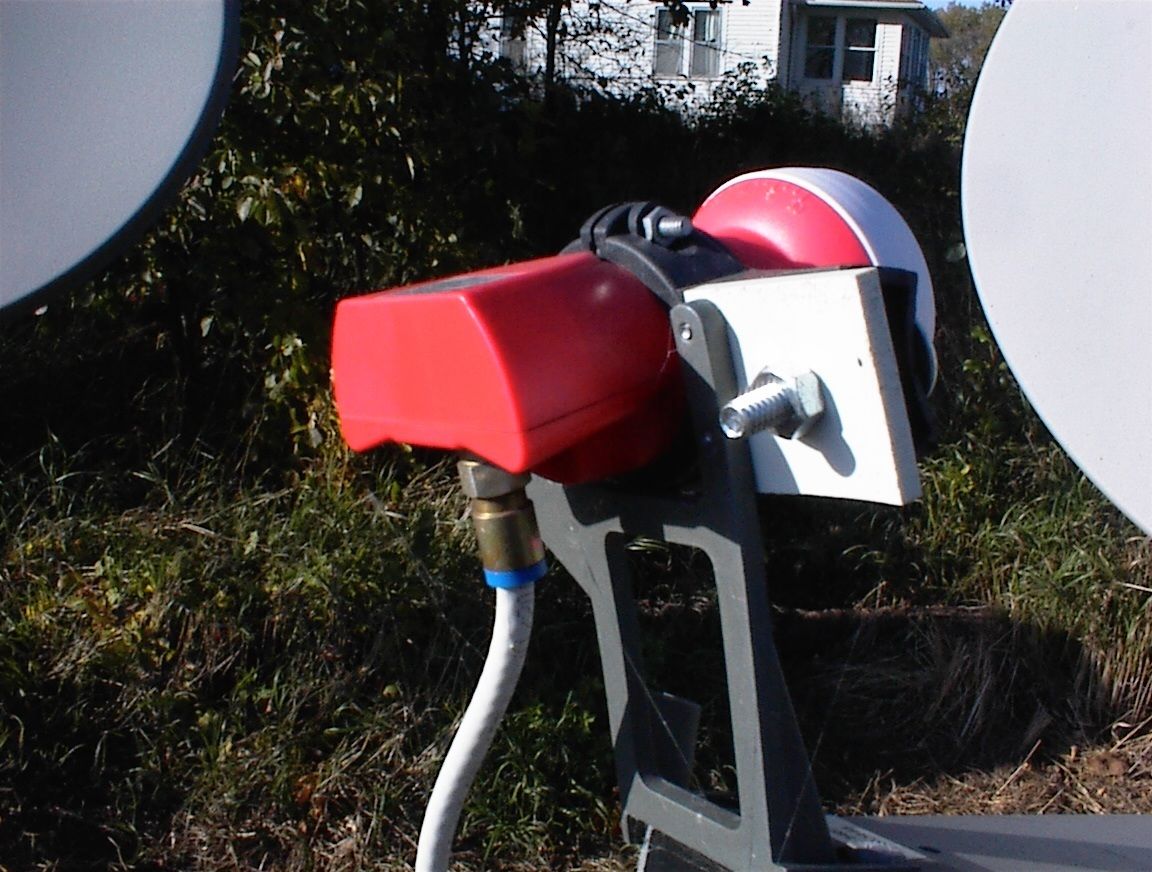

Eureka!
Functionally I'm done with this project and I'll declare it a success!
I sawed apart the other lnbf tonight and reassembled it using the donor pieces. It was another nice day today and a bit windy again. I was still using my ghetto shaky setup to test out the modified FSS+FSS Dish Network dish. I locked onto 123w first and retrojams with quality solidly in the 80s. Without moving the dish I switched the cable to the 125w lnbf and imediately hit a pbs TP with quality in the 80s. I didn't spend too much time tweaking but found usable signal on all channels on both birds without moving the dish.
The old white plastic lnbf covers won't fit any more. I was going to cut them and modify them but they cracked when I started cutting them.
What materials are invisible to satellite signal? Plastic, rubber, .....? Any suggestions on how to cover the lnbs?
I'm wondering what would happen if I put this lnbf on my winegard.
Joe;
A Very cool and clever solution, may I borrow the idea for one of my SD's?
As for the correct plastic for a cover, you have the setup for another great experiment!
Soda bottles, visqueen, landscape plastic, PVC, milk jug, teflon, glass, etc.
It would be a genuine apples to apples comparison. It would possibly solve the problem reported of some C band lnb caps wrecking signal Q.
Winegard 76cm? Too short a focal length, I'd wager.
Try it and tell us, or do the calculations (I'm too lazy and don't think it'd work)
What is your minimal LNB center-to-center spacing you can set?
In addition to all the interesting bottles 'n stuff Cadsulfide mentioned, what about some Tide Liquid washing detergent lids, or some Saran wrap?
Cadsulfide, this forum is all about poaching and improving on the other guys ideas. Go for it. I stole the idea from threads by Sidha and Anole among others.
I keep thinking about the properties of the cover I'd like to use. It should be stretchy and waterproof but the material shouldn't be too thick.... My mind keeps going back to using a condom but my neighbors already think I'm nuts and that would not improve their impression of me.
I live in a townhouse style building. I setup my temporary setup on my front sidewalk last night to try this out. I was waiting for someone to come pickup a nordic track skier I was selling so I set that outside on the sidewalk next to me as well and actually used that to weigh down the board the dish was attached to. This stabilized the dish some in the wind. I have a new neighbor who I don't know well. He gave me an amused look as he walked by. I was very tempted to yell out, "I need more power to contact the mother ship. Jump on the Nordic track and ski, man, ski!" In hindsight I should have gotten a pic of that.
I used to travel my Dish 300 and would cover it with a large garbage bag (black). One time I decided to leave the bag on the dish (covers the lnb also) as I set it up and did not have any noticeable effect. I decided to start leaving it on whenever I traveled or was home.
In another experiment I found the grocery store bags (just on the lnb) will work also but they degrade too quickly in the sunlight.
The problem is that many disposable plastic products are designed to deteriorate in UV light due to environmental concerns. Plastic grocery bags are an example of this. Garbage bags are probably designed this way as well. Something like Visqueen might work better in UV light.
