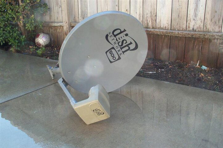

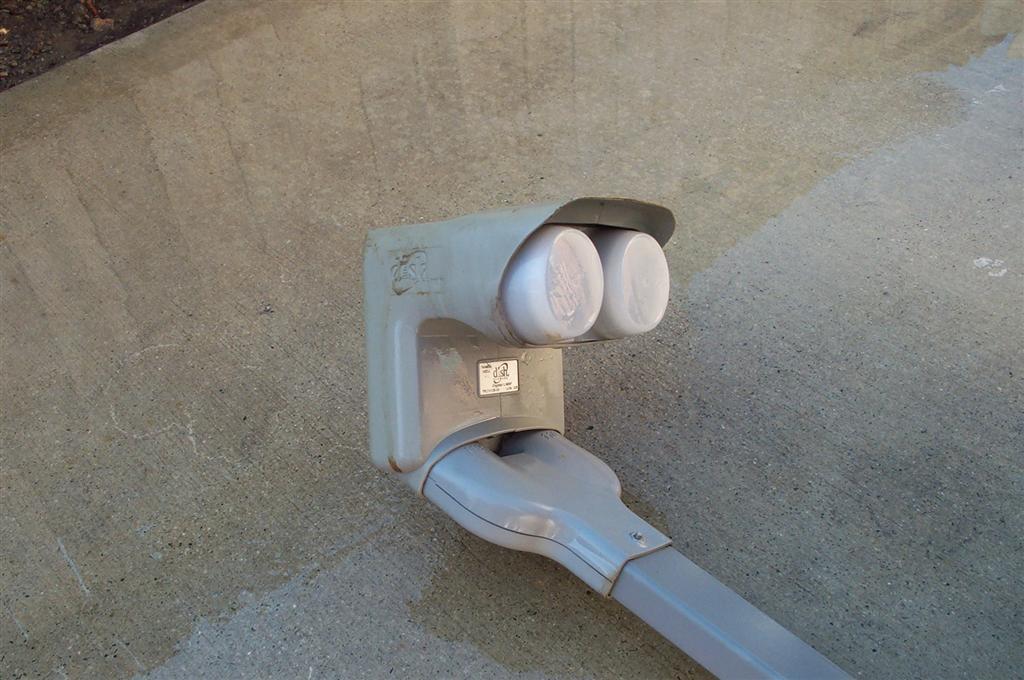

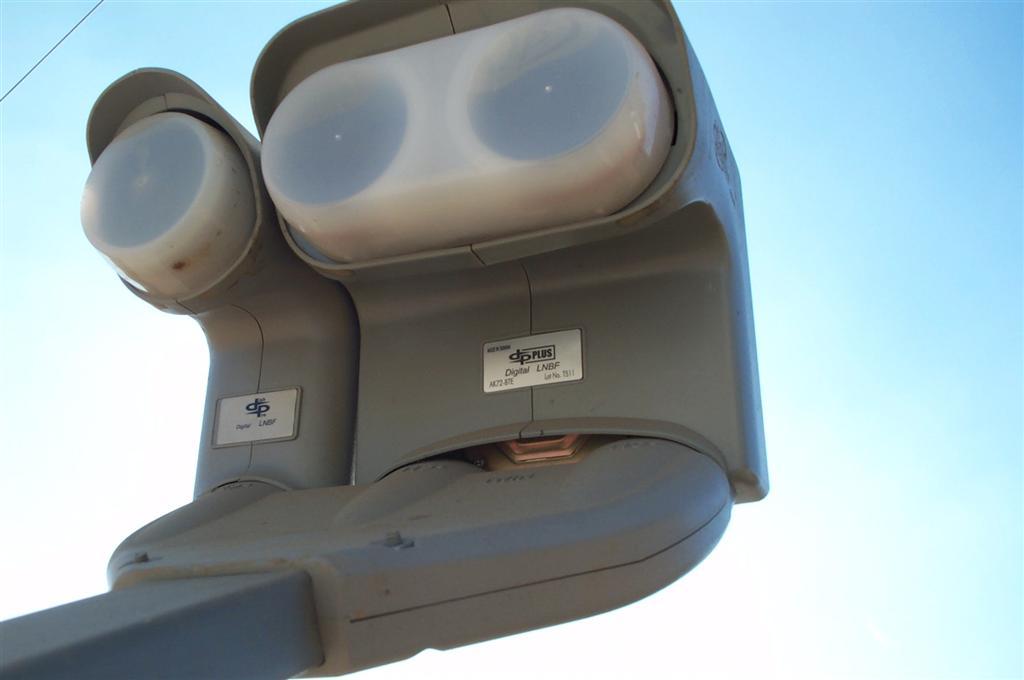

Here is some pictures of my current setup and the new dish I got.
Let me know if this will work.

The Twin on the "new" 500 is a legacy, so you can't use that one. I'd get me an "I" adapter to put on the 500, get the single LNBF off the 1000 and put it on the 500. Then put the "Y" adapter from the 500 and put it on the 1000, and stick the TWIN on that. Run a wire from the 500 to the TWIN of the 1000. "I" adapters are 8 bux at DISHstore.

So, you got an old Dish 500 with legacy twin LNB.
If it wasn't said above (possibly more than once) the simplest choice is to remove the legacy LNB from the old dish, and throw it away.
Now, attach an "I" adapter to replace the "Y" adapter on you old D500.
Then, transplant just the 129 LNB off your Dish 1000 to the "old" dish.
No realignment of your Dish 1000 will be needed.
Aim the old D500 with the 129 lnb to 129 (doh) and see how it goes.
Yes, you will connect the output of the 129 lnb to wherever it was previously connected.
That combination will get you the least improvement (if any).
If that doesn't get the job done, buy a 30/31/36" dish which will accept your 129 LNB, and use that in place of the above configuration.
There is a special Weingard which has the exact mount to take that LNB.
That again is simple, will surely get you the extra signal, and is the next logical upgrade path.
