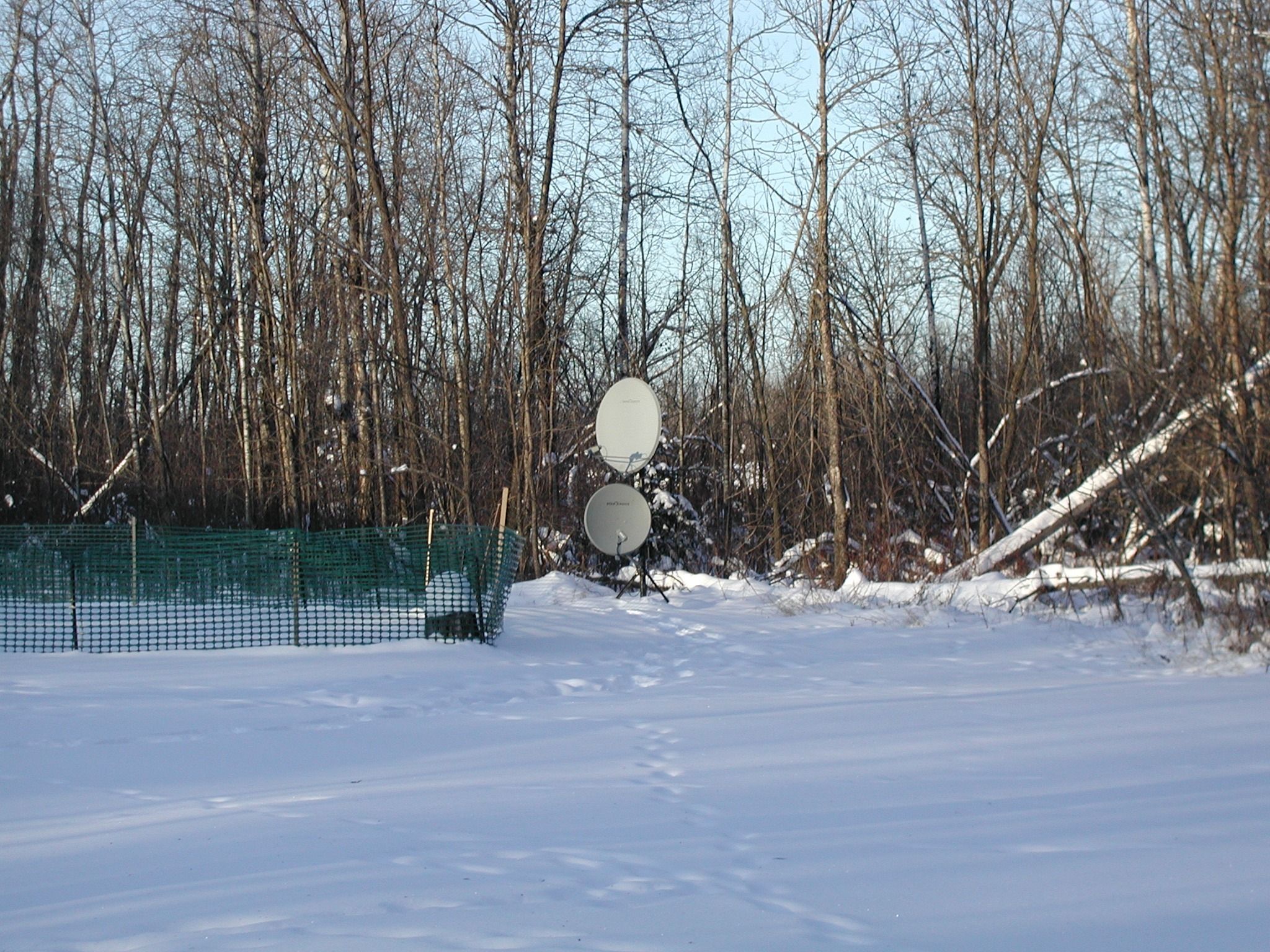

That's kinda what I'm doing here, the dish on top is a 1.2m Star Choice and the bottom is a 76cm Star Choice. The 1.2m is at G-10R with an additional LNB for Whitesprings and the 76cm is looking at AMC3 for PBS etc.
I took a mount originally designed for a 6' C-band dish and had a pipe welded to the top of it (I think there are some pictures in my gallery here) SatelliteGuys Photo Gallery - 4' extension improvements! - Powered by PhotoPost
