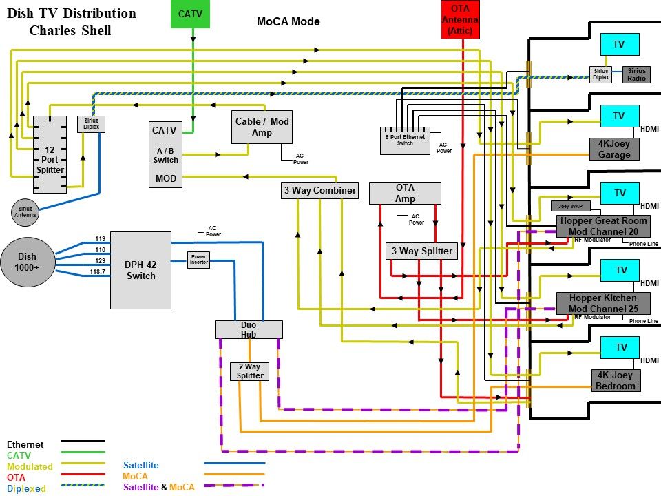

Conway here is my setup for two Hopper 3s, two 4KJs, and two WJs. Both Hoppers can see each other. As you can see I am using a Duo Hub. One H3 is connected to my router by Ethernet Cat cable. The other H3 is in Bridge mode. You probably have two Solo Hubs. I am pretty sure for your Hoppers to see each other you need a coax jumper cable connecting both your Solo Hubs, client to client ports. Maybe HipKat can jump in to help on why your two Hopper 3s can't see each other.
Reactions: MSEman and HipKat
