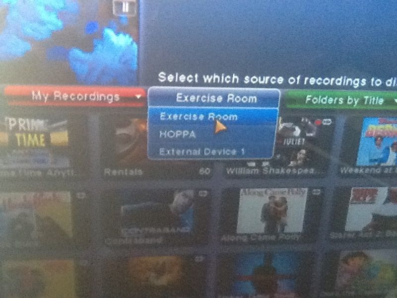

You don't need to do anything with the Whole Home screen. Those capped ports, I'm assuming they are the two To Client lines and your Hoppers are connected to the outside Host ports? If the reboot doesn't fix it, you could wait until tomorrow to see if the first nightly update corrects it, but normally it should work right away. I would personally wait till tomorrow but after that i would get a tech back out to check out the node. I attached a picture if my DVR menu.
<img src="http://www.satelliteguys.us/attachment.php?attachmentid=84748"/>
