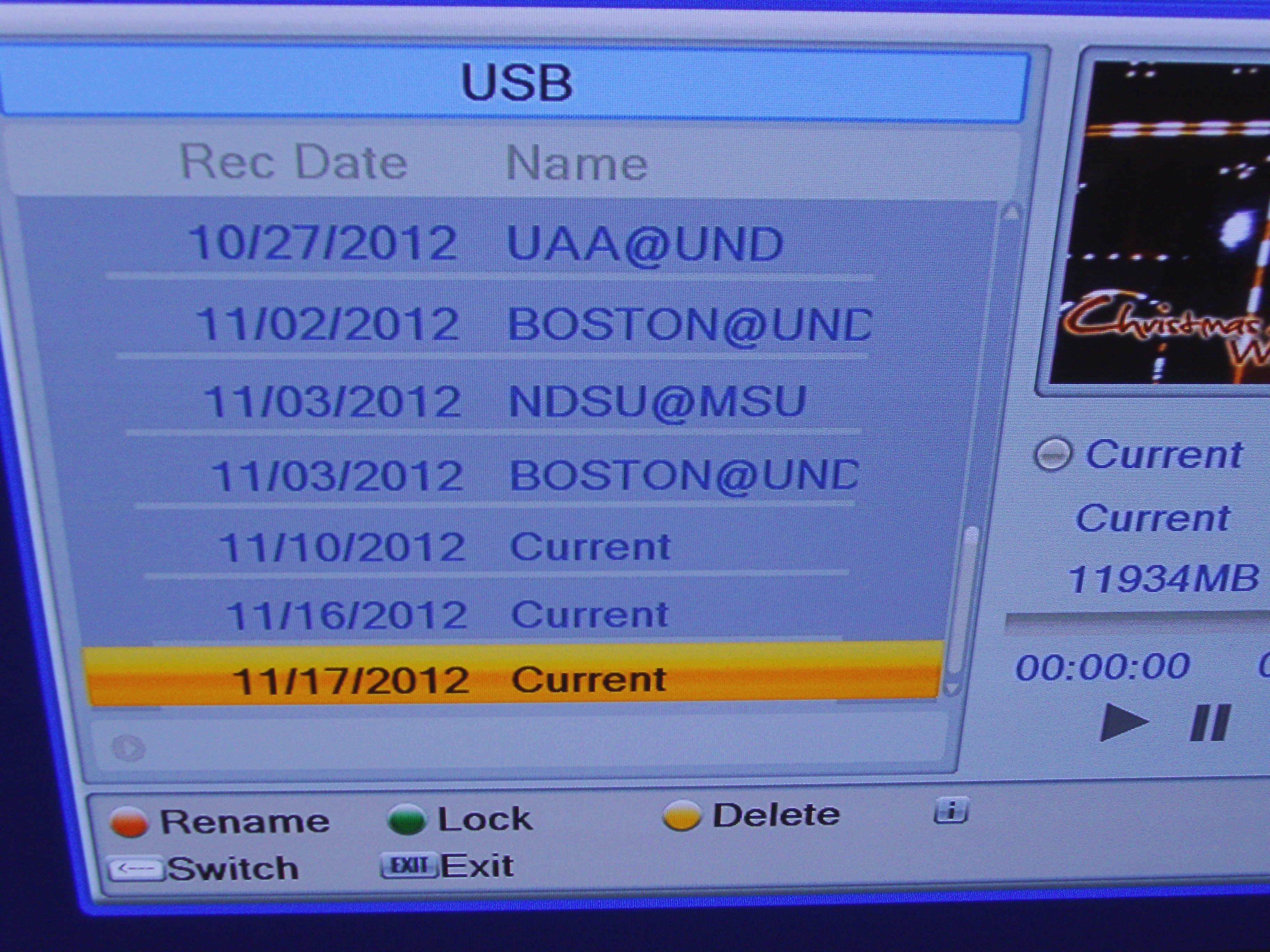

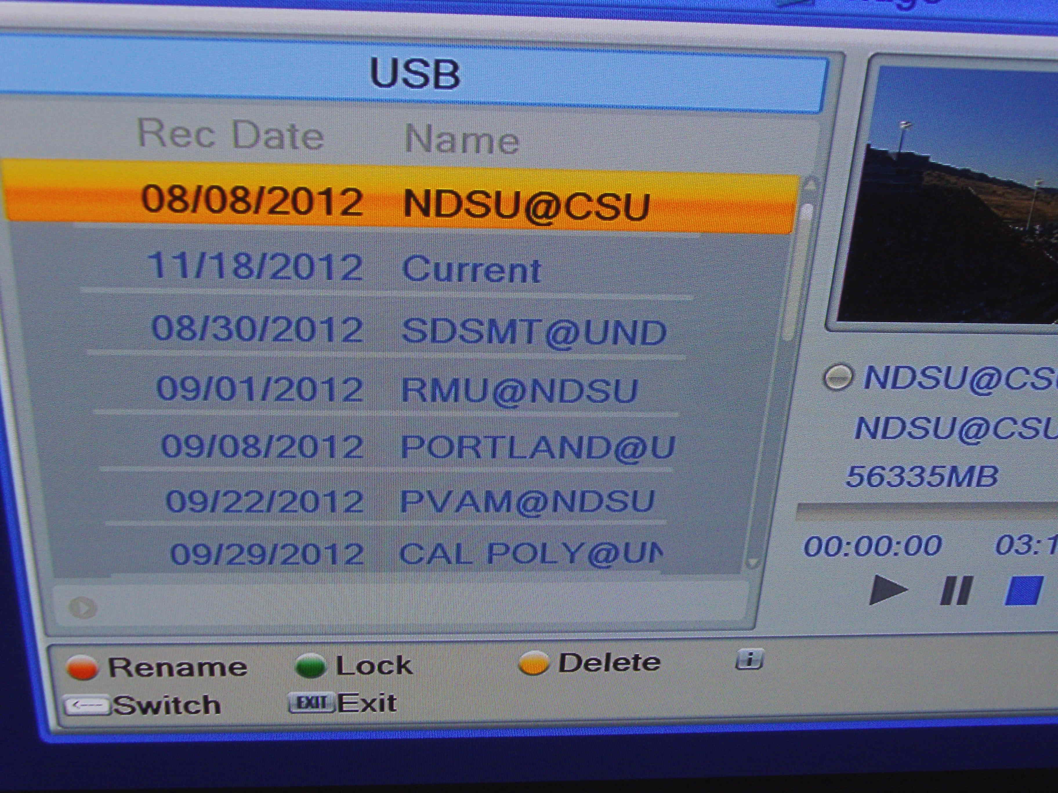

Also I didnt know if I would have enough on my regular drive so I plugged in my 500GB drive. Once it got done I copied it over to my "regular" drive. Even though the date is correct it put the file before anything I recorded directly on the drive and after the football game from 9/8 (but I dated it wrong so thats why it shows 8/8).
So it seems like any file transferred from another drive it puts at the top of the file list (in date order)...see pictures
1st pic is the 1st part of the list..."Current" is the file in question
2nd pic is the end of the list (from a hockey game last night)

In pic 1 the one that shows the date of 8/8/12 that was my screwup....I set the time wrong on the Manhattan (should have been 9/8)
But the one I copied from drive B to drive A (Drive A being the one I usually have hooked up) it sorted the file and put it 2nd on the list
So what you're saying is if you copy it from another drive it goes in date order 1st then the stuff recorded directly from the Micro?
Files that I have dropped on the drive always appear above the recordings made on the STB. I think that is what you found. If not, sorry. Maybe I am not understanding the issue.
