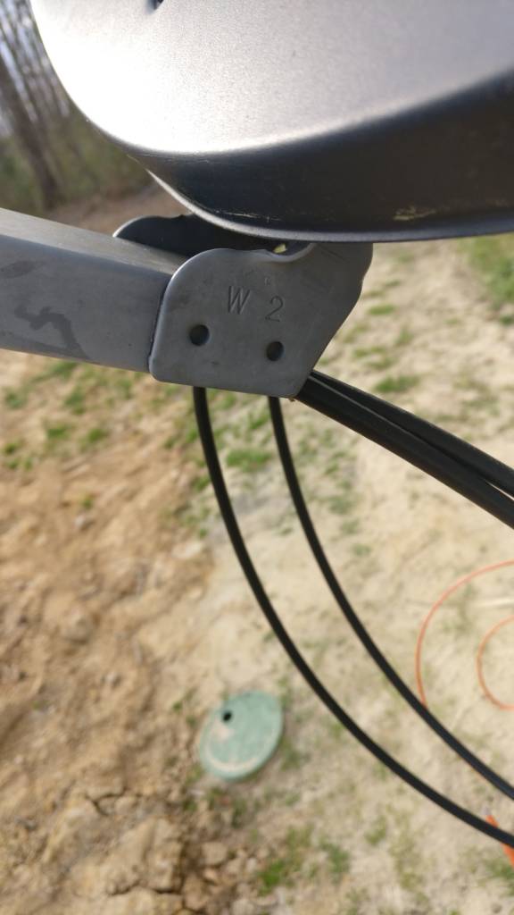

I've been thinking about that as well. The dish was an old leftover that I collected but the LNB is new. I noticed a "W2" on the LNB support arm as you can see in the attached picture. Does this mean that this is most likely a Western Arc reflector? No matter what I can not get 72... Only 61.5 and the strongest signal I can get is 35 but at home (just a few miles away) I get 50+. There are no line of sight issues as I am on a 25 cleared acre plot of land.
Sent from my ONEPLUS A3000 using the SatelliteGuys app!
There is no EA and WA reflector - for EA and WA the reflector is the same.
Move the dish right until you loose the signal and see if new one will show up , you may getting the 61.5 with the 72 horn.
