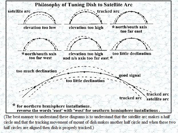

Finding your true south and the closest satellite to your true south is the first step. To find your longitude is easy, go to www.dishpointer.com and type in your address, zoom in to your property and move the green button to the exact location where your dish is and note the longitude then look at the satellite list to see which one is the closest, i.e., if your longitude is 113.4° then you can use the 113.0°W SatMex6 satellite to aim at and lock onto a frequency signal. Then you can tune the dish and motor elevation for best signal, if you used the declination chart that came with your motor you should be close enough or right on the correct declination. Fine tuning the declination can be done later in the process.
Keep in mind that you can't always find a satellite as close as the example I mentioned, sometimes you have to use a satellite that might be 2, 3 or more degrees from your true south. The satellite is only for reference purposes so you can find the general location of true south. On the other hand your true south might be dead on a particular satellite.
Once you've accomplished finding the general true so. you then navigate the motor to the far east and far west ends of your horizon. starting at either end you'll seek a signal from another satellite, being the 125.0W on the west side and maybe the 72.0W on the east side, you may be able to go lower on the east, this depends on your location and a clear line of sight, If there's no obstructions blocking the signal.
If you can get a signal from both east and west satellites, you're almost home, if you can only get signal from one end then you have some adjusting to do. Study the chart I attached and get familiar with it, understanding is essential for tuning the alignment in all respects. I won't write a book in one post so take it from here and see how far you get, ask for help if you get stuck. You have plenty of help here and lots of smart people, take your time and good luck, enjoy the experience! :D
