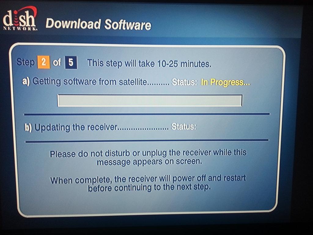

So you're saying it doesn't even do acquiring signal? That's odd... Could you take a pic of the screen it's stuck on?
Sent from my iPad 2 using SatelliteGuys
Sure...
This is the problem. Can't get software without a Sat signal, can't confirm Sat signal without the menu.
Thanks for the link. By resetting with the power cord, I never get to a menu allowing any remote entry at all. It simply boots to this screen.

As the thread starter showed in his picture , you can't get to checkswitch screen with the new initial software download. You can't get even to that screen until it downloads the initial software-only available on 119 sat-according to the screen . If you don't have the 119 sat in your matrix you can't get that initial software download and can not progress to the checkswitch screen. IF you notice the DISH software team showed a trick you could do to get to that screen pushing some buttons on the remote control ,but this is the first time I have heard of this. When I called the tech department they kept saying there was no way to fix the problem on their end and they certainly didn't know of the remote control buttons you could push. The only way out was to add 119 sat into my matrix and the software finally downloaded. It is a problem that they need to FIX in their software screens ,especially for replacement receivers. As I pointed out to them and to y'all in this thread ,the first screen on the receiver should be the checkswitch screen and then download the initial software. This is how the receivers worked before the last year and it didn't cause these problems. But as usual DISH won't change it and this is what causes their customer call ins and truck rolls to soar. Just fix the software screens and it would be an easy fix. Not many subs know about the 119 sat that needs to be in the matrix or the special buttons to push on the remote control to get to the checkswitch screen. I've had this same problem when I first got the 722k , the 922 and any replacement receivers I have had in the last 4 years ,since I went with the eastern arc dish. Luckily I had a side sat from before that I could easily aim to 119 to get my receivers to download the initial software and activate. I now keep it in my matrix all the time so I don't ever have to go through this. When I got the hoppers I had no problems activating them ,because 119 was there and it grabbed the sat and the software without ever doing a checkswitch download a few steps from there.

When software spools, it spools on both EA and WA. The situation listed above may have been an error in spooling or some type of problem that occurred. The installation wizard should complete on its own and be simple to get through and complete. If a manual check switch needs to be run, Point Dish can be accessed while in the installation wizard by pressing * # *.
If the installation wizard only looks at 119 for a software download, and the customer doesn't have 119, how is spooling to both arcs going to help? IMHO all software, if it forces anything at all, should go to the check switch screen first.
