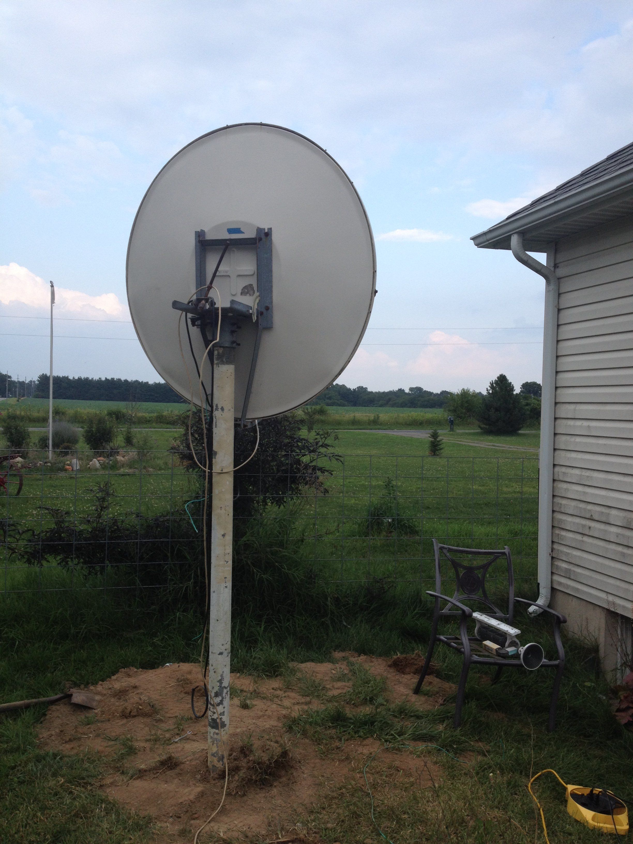

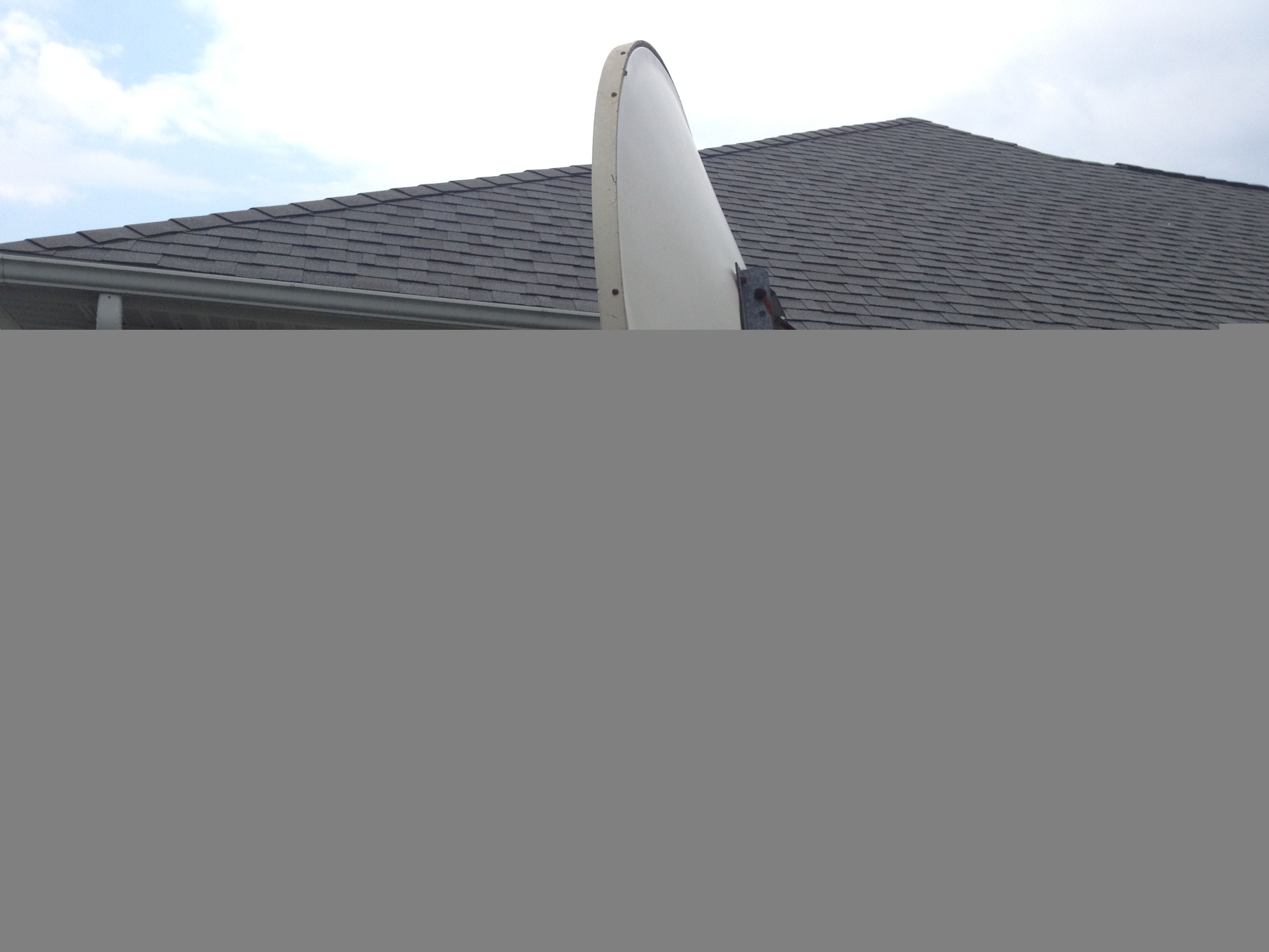

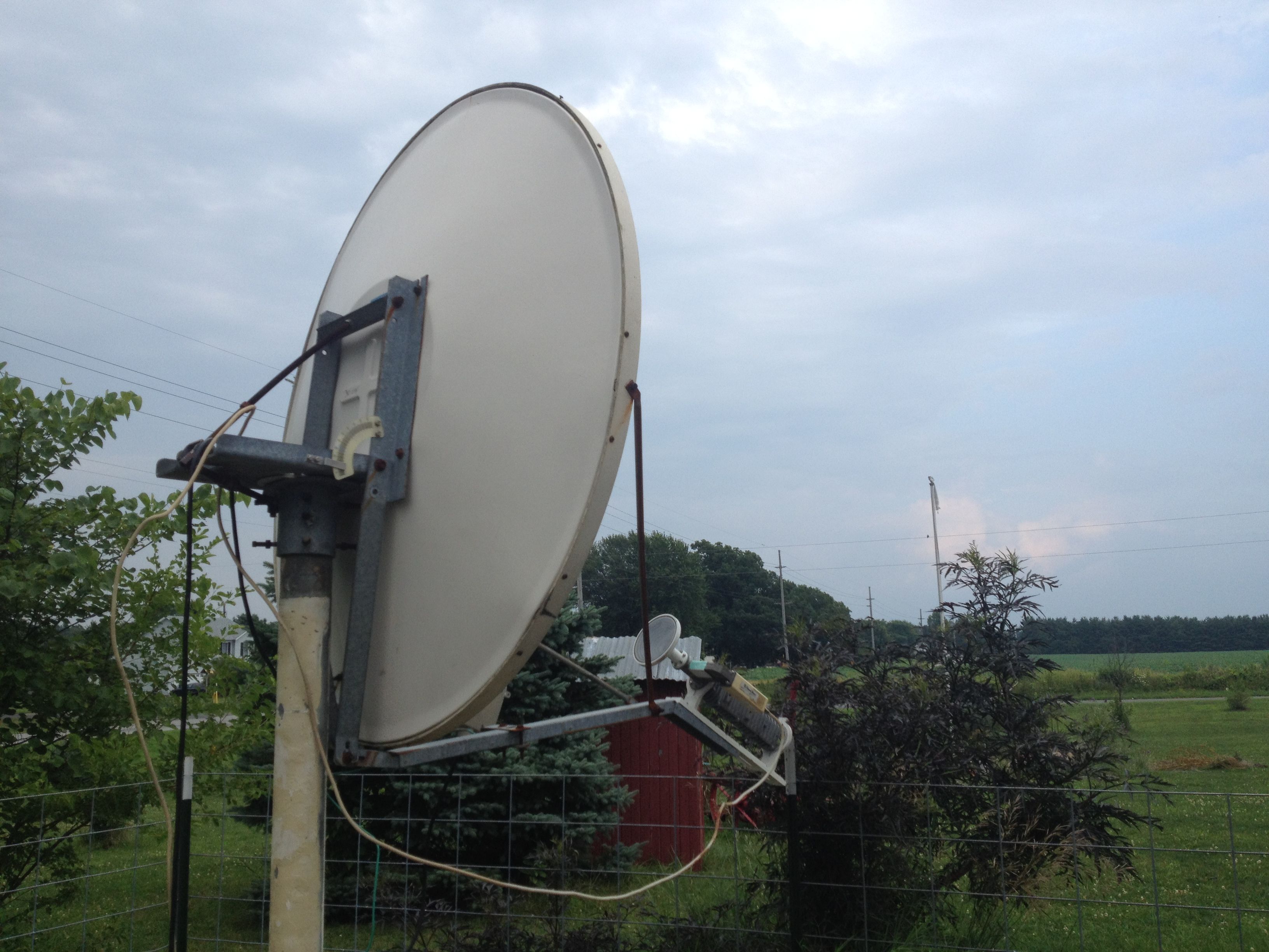

I found 2 problems. First the dish doesn't go low enough. Second I tried the feed assembly on a dish on 91 and nothing. Is it possible for a feed horn to go bad? I am certain the LNB works because I tested it on another dish. I'll post pictures tonight.

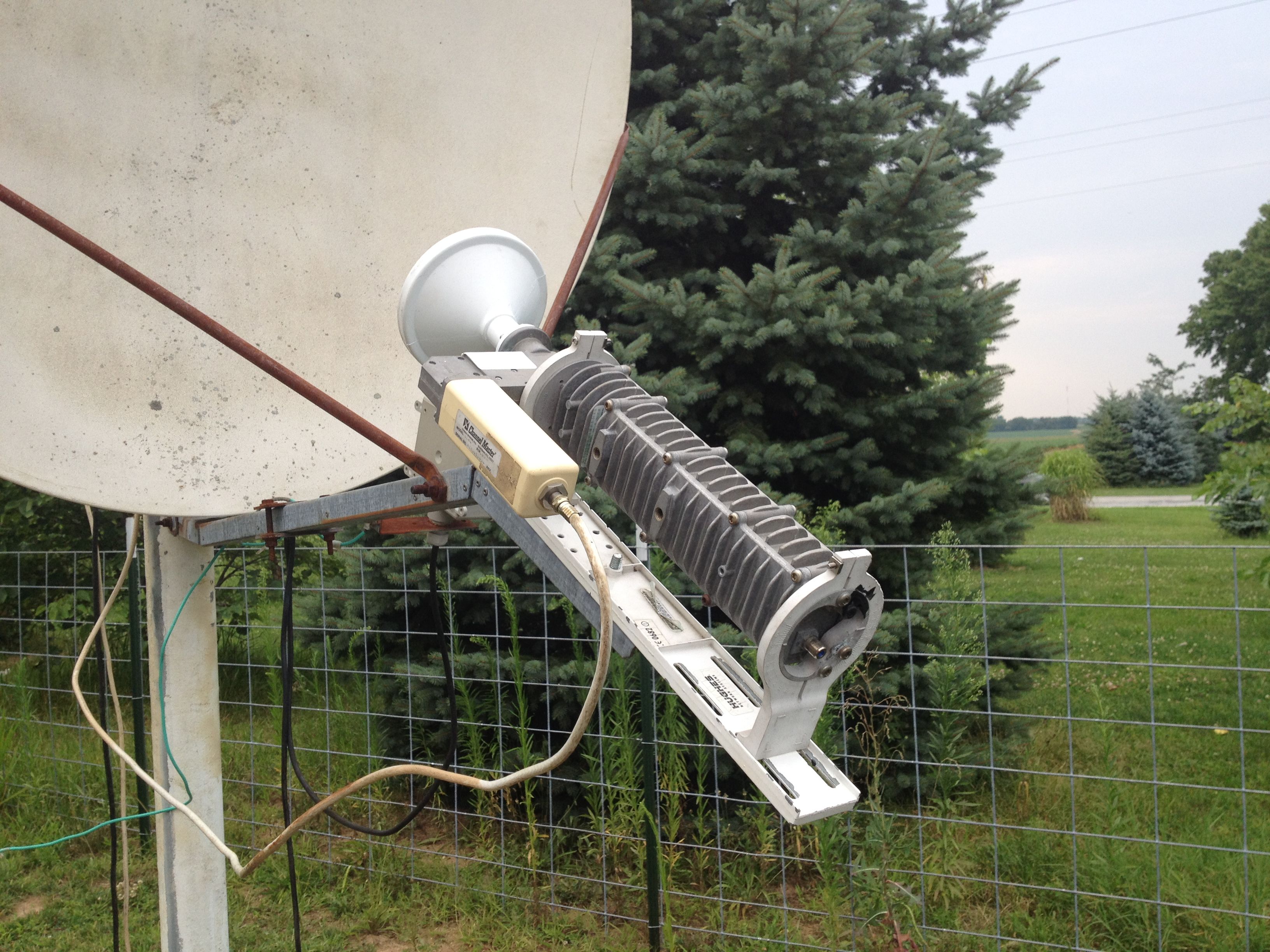

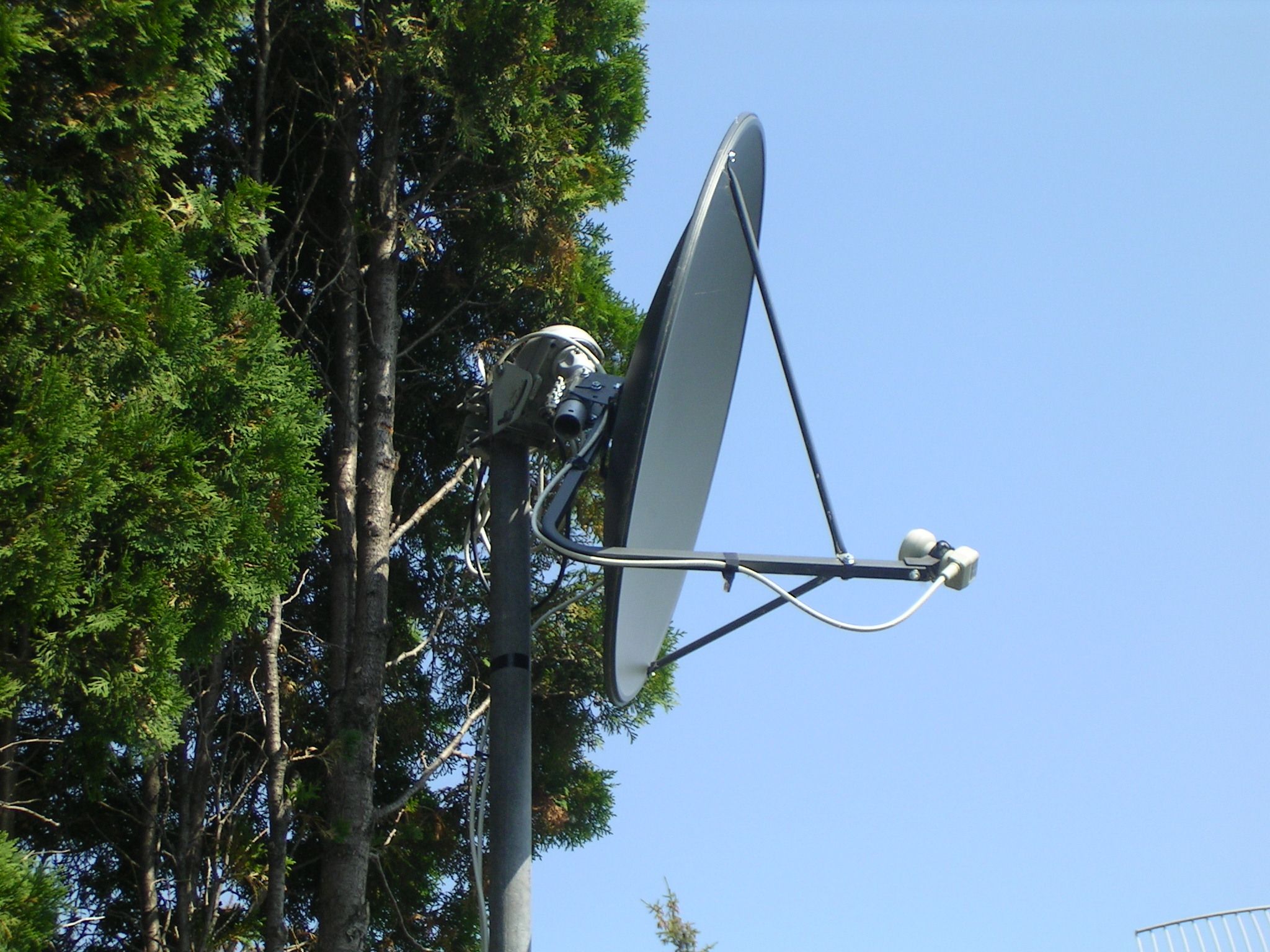

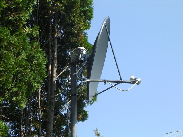

My 1.2 didn't go low enough in the 'standard' arrangement. Sidewinder' fashion works great. 30W is only 6.4° above horizon. Didn't go inverted to prevent snow buildup.

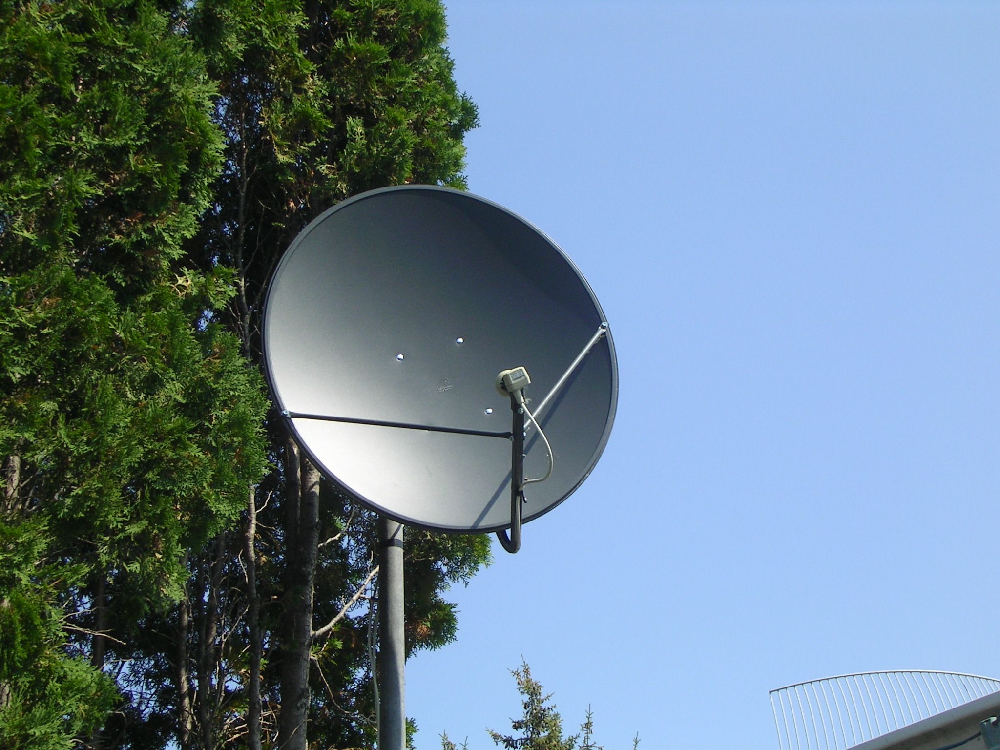

Here's also a pic with a 30 inch I tried in the inverted arrangement (worked just fine)
Went back to using the 1.2 to combat weather induced fade.
Bug nest inside the feed throat??
Works great right-side-up on a motor... Mine gets 30w to 125w no problem...
(I have to use diseqc 1.1 for anything farther then 40W, USALS won't go that far..)

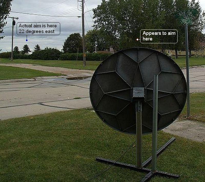

There are trees to the south and east too... but farther away. I needed to set this up above roof level so it could see the eastern horizon without having to sit on the driveway or lawn...
30w must be quite low on the horizon up your way?

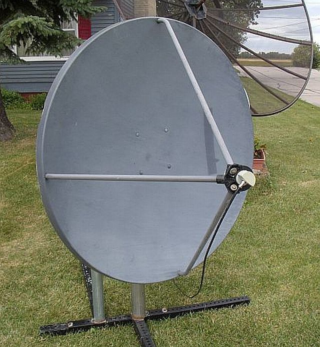

The face on my dish is actually pointing down slightly off vertical.
He's approx 1° north of me, and my 30W elevation is 6.4°, so imagine it's closer to 6.0°.

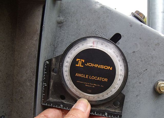

You are fortunate that your dish will go down that low. I actually had to tilt the mast when trying to get the sat at 8W.
You're right about the "healthy signal" I'm amazed that it does so well with my 25" dish.
My elevation for 30.0W is 16, like jorgek I will try tilting the mast because I thew a circular LNB on it and swung it around and hit 129 with it at its lowest. I tuned it to 91.0W with a circular LNB and put the original back on and got nothing so there is also something wrong there.
