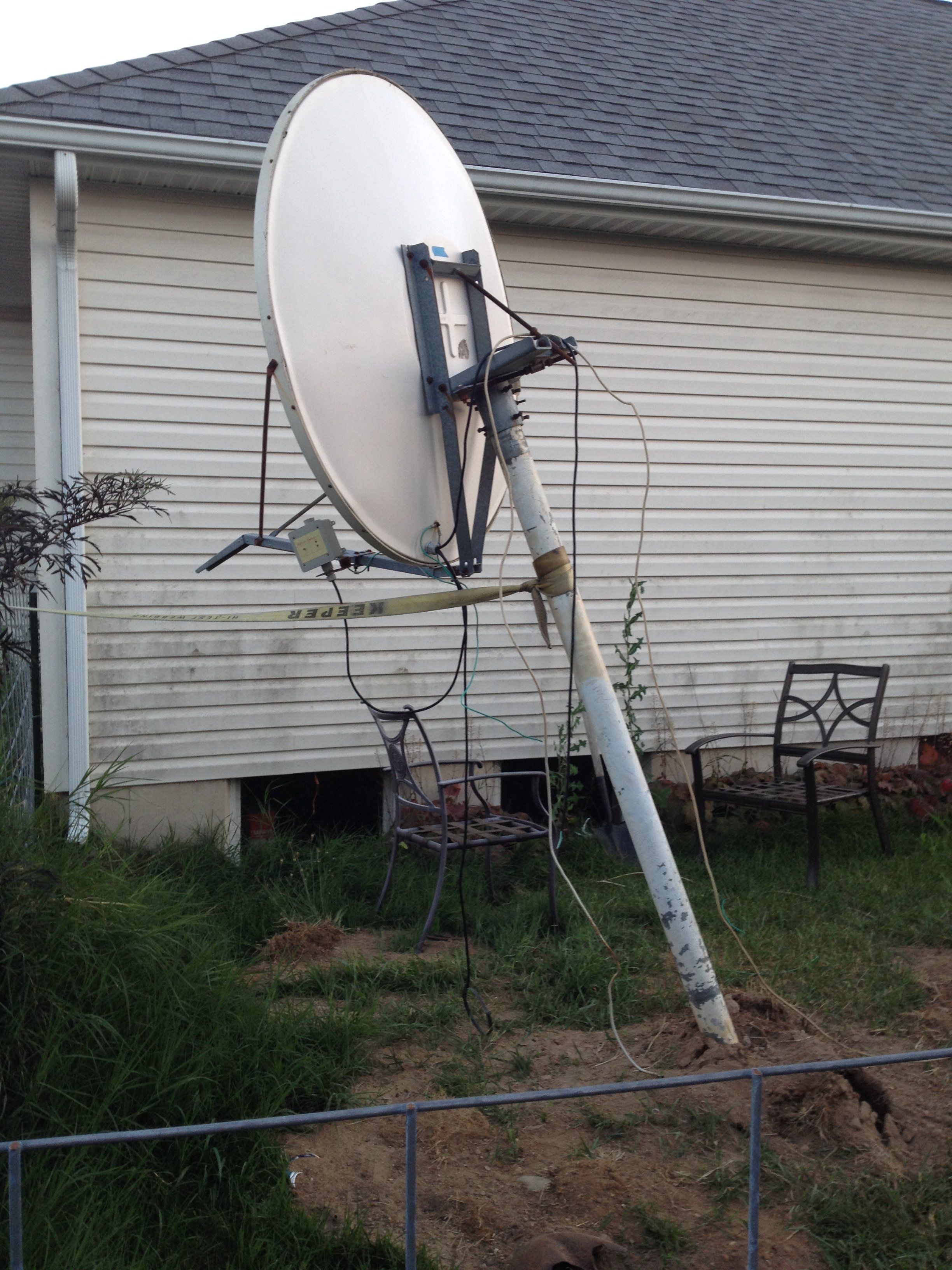

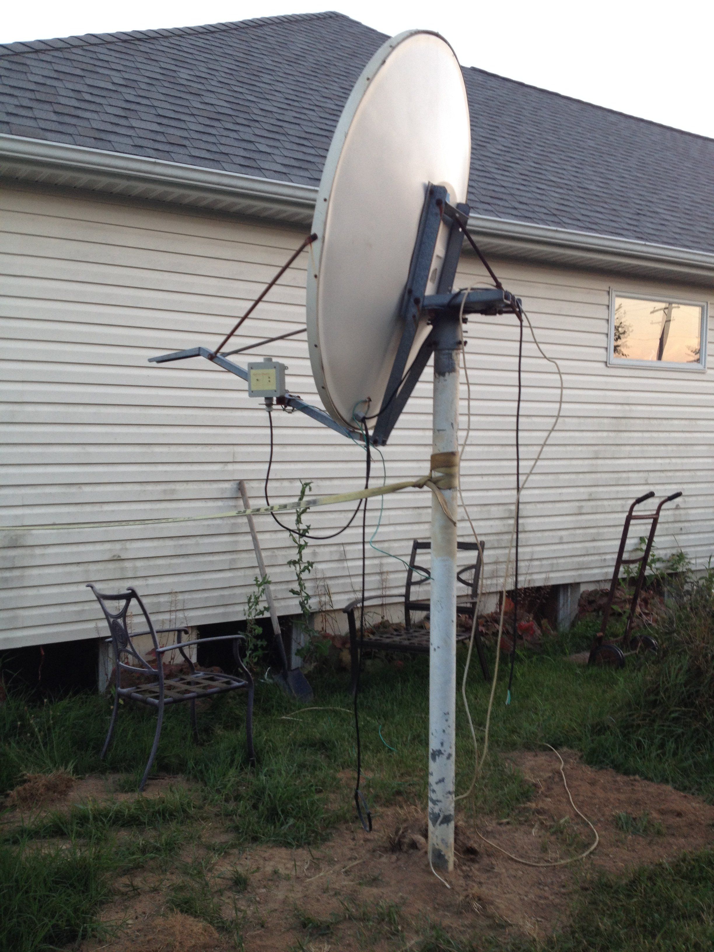

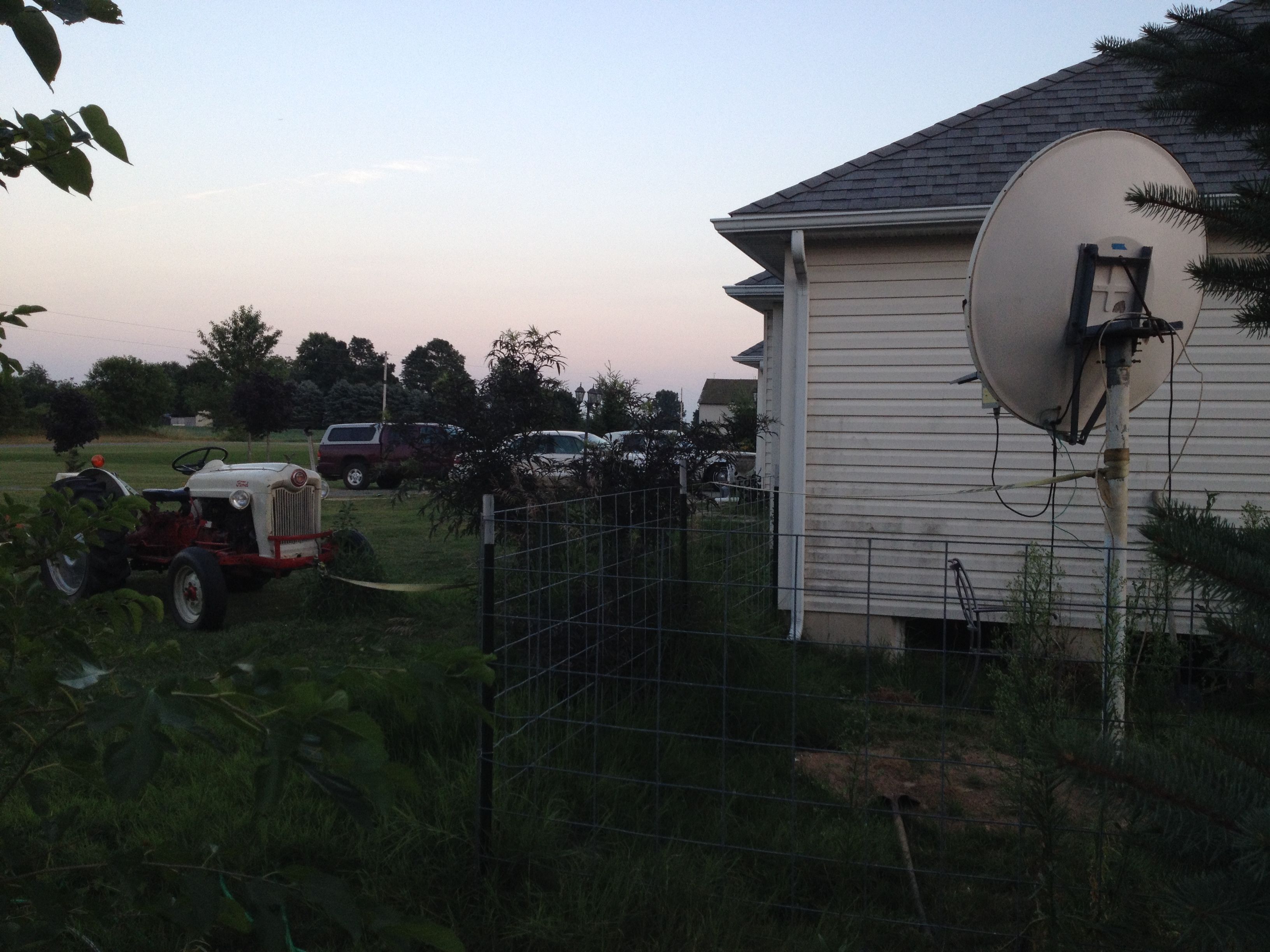

The only way I could get a stationary dish to work was to install the LNB arm on the top so the dish was upside-down basically. It worked ok on the ground but works better on the elevated mast with the motor. The Red River is about 1/4 mi to my east with tall trees along the bank, there should be at least 2-3 degrees of space between the satellite and the trees as viewed from my site, but there seems to be a bit of interference somehow. Microwave engineers call it Freznel Zone, where the radio waves can bounce off the nearby object and arrive slightly out of phase to the main signal, cancelling it out a bit. I suspect that is what is occouring.
Raising the antenna 15 feet seems to have helped, at least in my case.
Hopefully this is enough tilt.

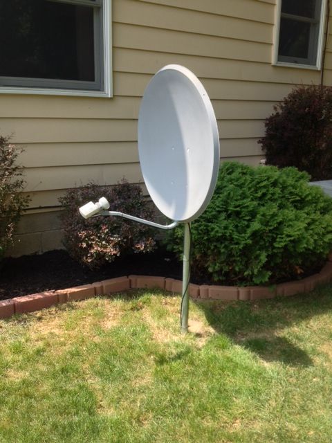

My neighbor thought the same thing. My dish is stationary and pointed at 30W. It looks like it's directly pointed at his house. He jokingly told me it was an infrared dish used to spy on him. The dish is almost perfectly vertical here in Ohio. (See image)
