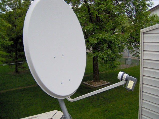

I tried searching and couldn't find much about this dish. Is this a good quality dish, I plan to use it specificaly for G18, will it work OK.
sure it would work just fine. I use to have one a while back. Dish works great for fixed system but you cant motorize it easily due to the bracket.
I had one but after a fair amount of wind the dish would flex real bad....

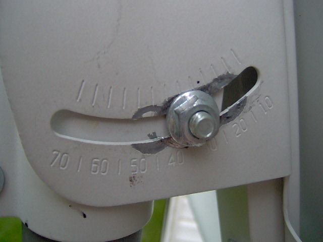

Here is a pic of my old one. I dont know if they have a new model or not but with the model I have when adjusting elevation the centre of the nut is what you use
