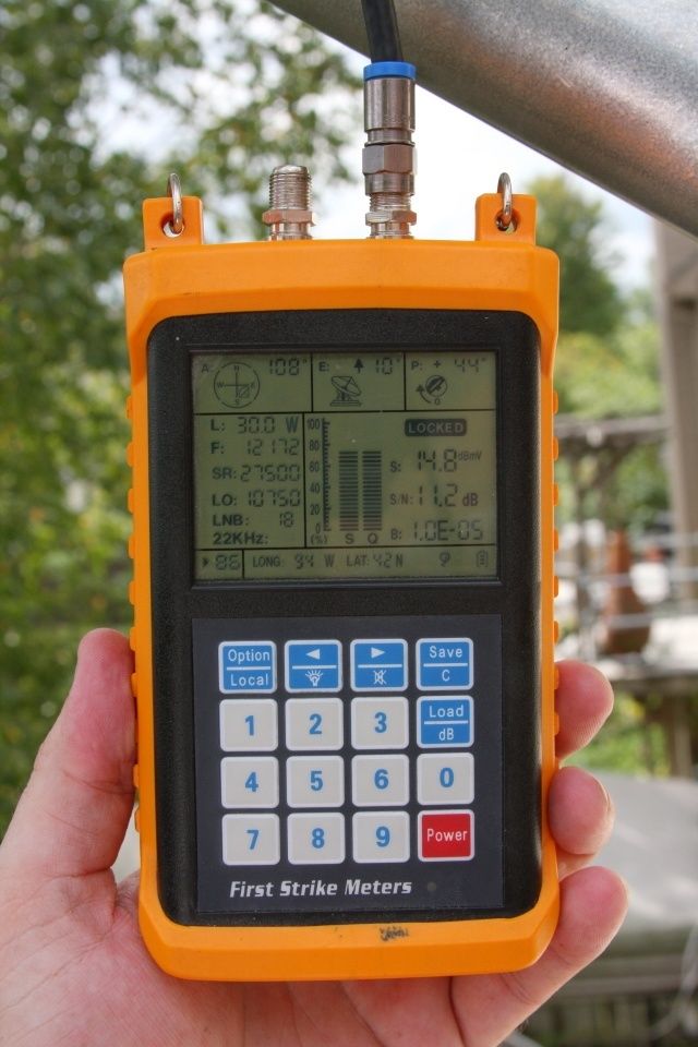

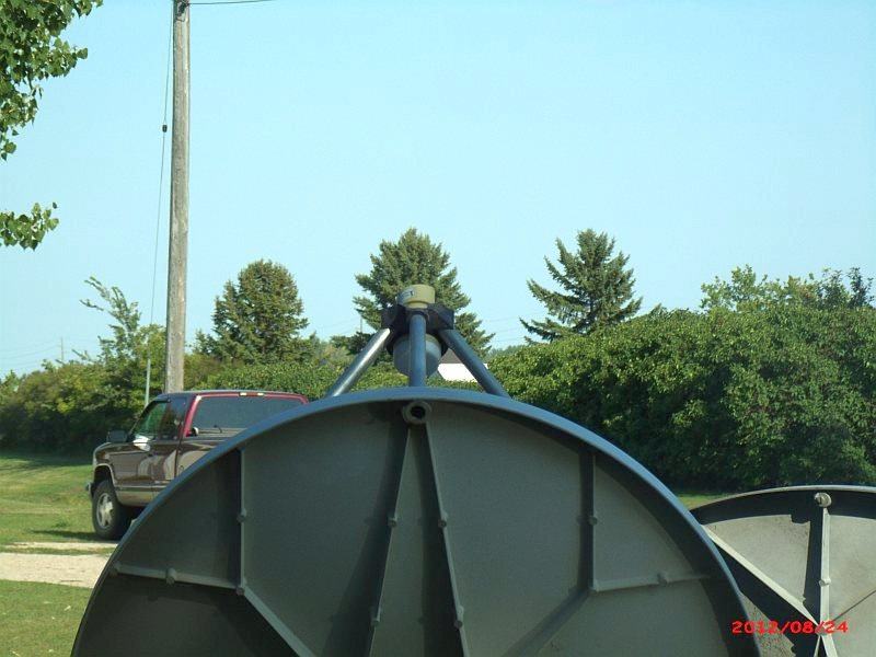

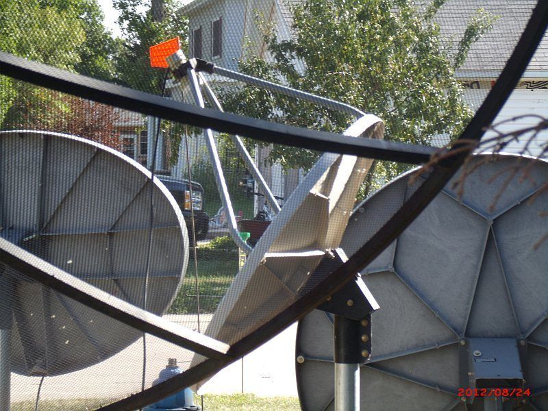

Well, I finally put a 30 inch up and aimed it at 30W to compare to the 1.2 meter. (Both ChannelMaster)
I also inverted it to get it down to 6° elevation. (same problem with not being able to go that low in standard installation configuration)
tp, Q-1.2m,Q-30
11883,74,60 solid
12.091,71,37-44 pixelated
12171,77,60 solid
12050,74,35-40 hard pixelation

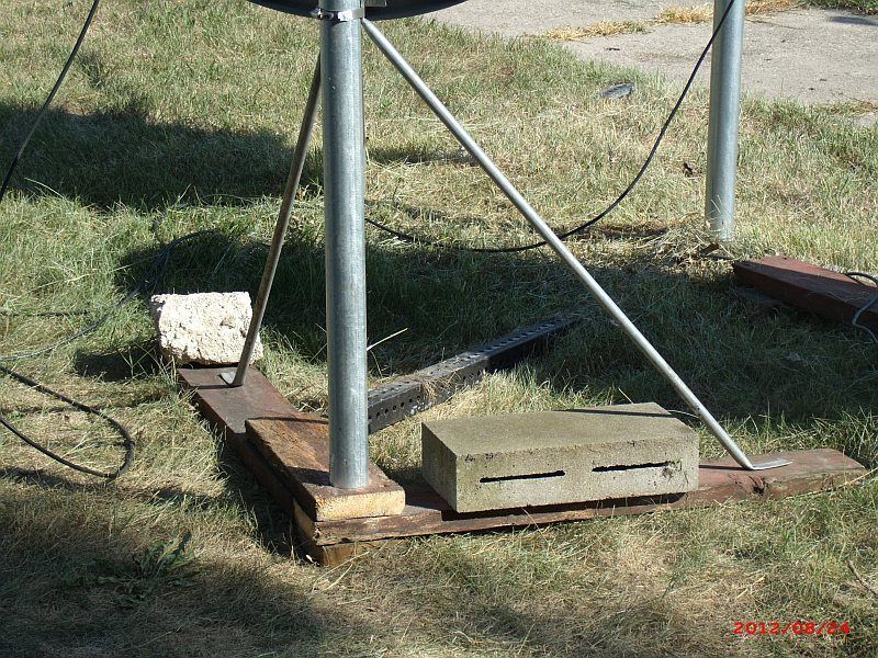

Think part of the problem is I was hot and sweaty and kind of in a hurry to get out of the sun. Should maybe have tweaked some more. Also think I have a bit of the 30 shaded by the sideways mounted 1.2 that's also aimed at 30W. Also confirmed that 30W here is just above, by only a couple of feet, the neighbors pine tree. Yeah, another 'temp' base - exhaust pipe, conduit, and some recycled decking. SS hose clamp and some deck screws. Oh well, other plans for it eventually. Maybe a universal LNBF and see if I can get some other international birds.

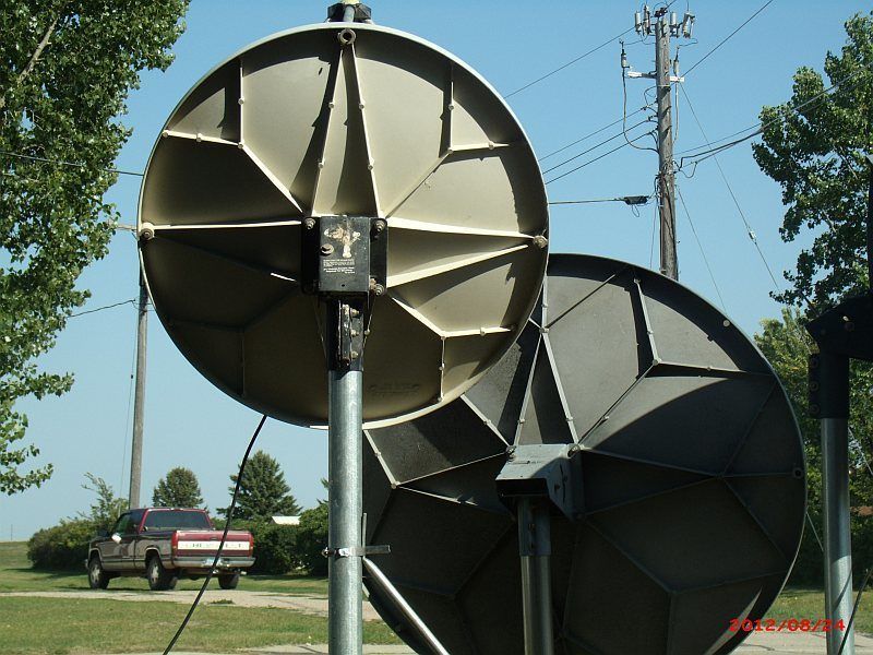

How much of an issue can this cause? I'm still piecing together everything I need, but according to the DishPointer app 30w (for me) is just above the treeline. Could one branch in the way really degrade the signal, or would it just be a minor inconvenience? My neighbor in another building has a DirecTV dish on his first-floor patio looking straight through some trees, but would an FTA signal be affected much more?

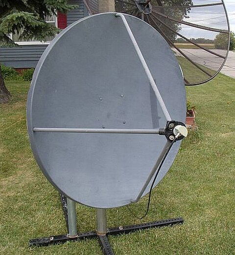

Well the shaded portion of the dish is more than what first appears in the photo. You can see the tree in the distance, below the dish, I'm 'shooting' over so if adjusted to place that point in the center of the 30, think here that almost half of the 30 is shaded, meaning I may try with a 'pizza' dish. It's a stout signal even at only 6° elevation.

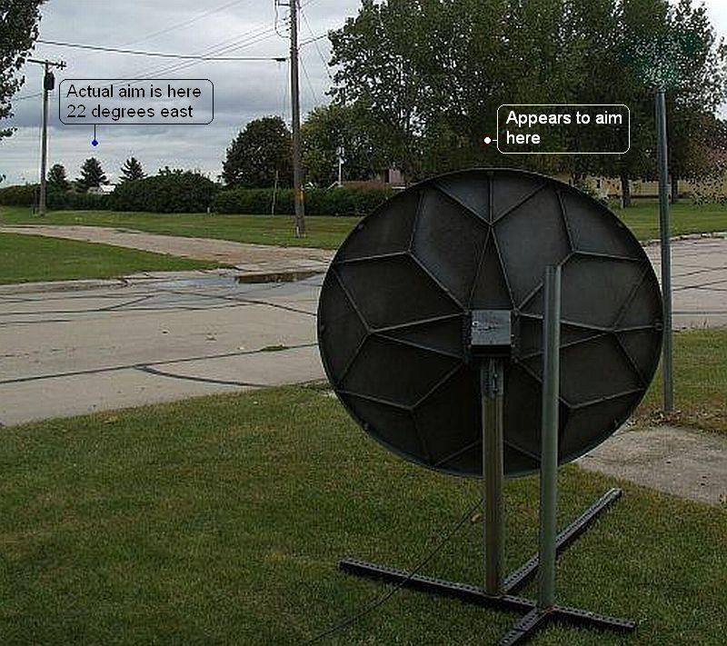

Your dish face may be aimed right at the trees, but is actually looking up offset degrees, 22 to 27 degrees. My 1.2 on 30W is mounted sideways so it appears to be aimed at the trees.

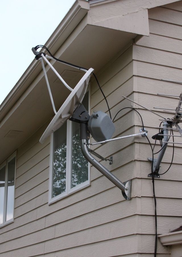

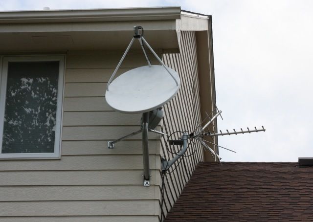

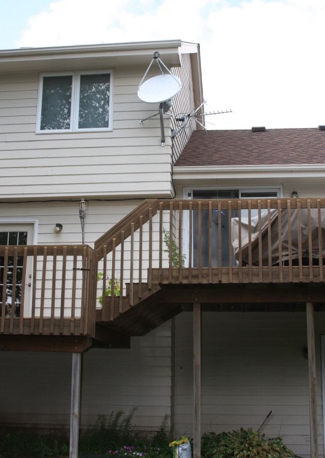

I finally got around to setting up a dedicated dish for Hispasat 1C & 1D. I spent a couple of hours on Sunday putting the J-mount on the house, inverting and aligning the dish, then running the coax cable from the dish to the Digiwave 8x1 switch on the south side of my house. Things are coming in great!
Now, I need to update my signature to include this dish...
