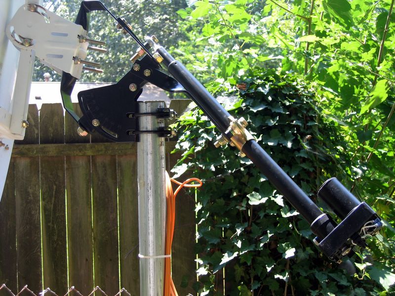

36V Actuator and V-Box on the 120cm is working.
Cascade
Goose.
Jun 1, 2004
1,457
37.134004N 76.561779W
To save myself chewing up another motor I put a standard 18" actuator along with the DMSI V-Box on the polar mount.
I have no need for the Diseqc actuator now as the Vbox stores and controls the 18"BUD actuator perfectly and pulls the 120cm dish up from both far ends of the arc perfectly, the actuator and the V-Box have more than enough power.
I still need to slow the actuator down a little, I think either a 25Watt resistor or a longer pivot arm will do the trick, I thought a 200ft run of actuator wiring would help slow it down but it didn't.
It's gonna be a long weekend.
Awesome Cascade. My actuator and V Box should be here Saturday and I will be able to get my 1.2 up and working. Keep me informed on slowing down the actuator because we have the same hardware setup. :D
I think I'll take the 6" axis arm and replace it with a 9", the 18" actuator should be long enough for the job, it arrived in a coffin - a lot bigger than I anticipated.

The coax run was too long to power the actuator so I went to a 36V system along with this 18" jack - I figure if a BUD mover wouldn't work, nothing will.
