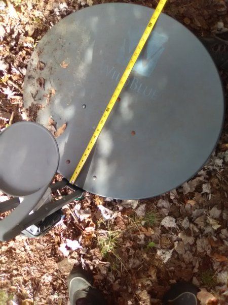

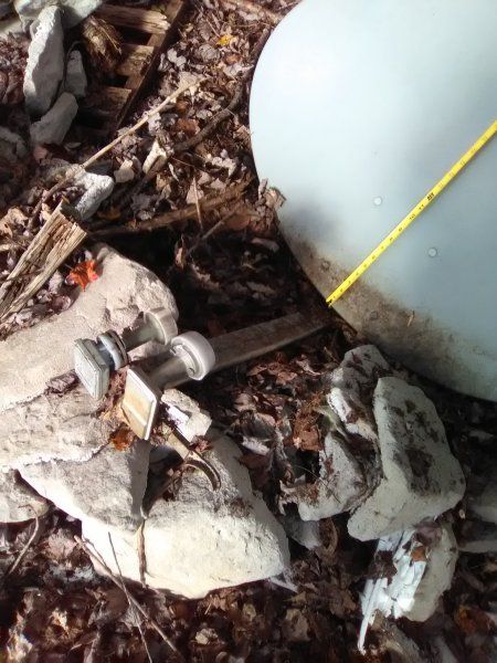

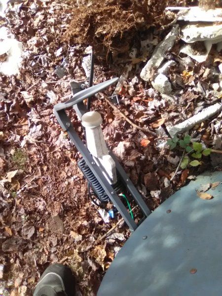

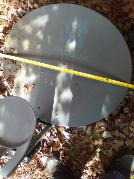

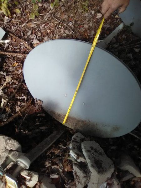

I had some additional dishes lying around, so I figured I'd let the Ku Experts look at them. I was wondering what options are available for mounting a linear LNB on these two dishes. It looks like the WildBlue dish would be the biggest PITA. Both dishes may be too small, but figured I'd check it out. Any suggestions?

You can reuse those dishes but they are on the small side but it can be done people have done it before.

There's a HughesNet internet dish up there that measures 39 inches across, but it's a lot smaller up and down. I guess it could be used for picking up horizontal channels, but may be a bit lacking for the vertical channels. :)

I think I see a DN Superdish, with the dual feed for 119W and 121W. The feed that is centered (for 121) should be linear and have a stacked FSS LNB that covers the regular Ku. In other words, if it is what I think it is, it's ready for Ku reception as it is. I'm using one of those for KBS on 123 and it's working great. Note that those LNBs are not very good, and the few I have played with were off by about 8-10 MHz, but they work well enough for stull like KBS or the CGTN channels on 95W or the RT/NHK mux on 103W. Also I think there's a hole in the arm that is well positioned for a typical Ku LNBF bracket, should you decide to use a new, better quality LNBF. With that dish you should be able to easily get many Ku satellites. So it's usable with minimal modifications.
Just keep in mind that those smaller-than-recommended dishes will not have much margin for rain fade.

I played with the dish pictured with no results. I used my Amiko receiver and a SatLink meter and could not get a signal with this dish at all. I am doubtful that the LNB on it was working, so I took a FSS LNB off another dish and installed it on this one. Still nothing. I tried a variety of LNB settings with the Amiko receiver with no results, so I ordered a Universal Ku LNB and a conversion mount.
This dish and the LNB's that were tried had been stored out in the weather, so I'm doubtful either of them are functional. I was using 97W as a reference satellite to see if this dish was functional, but didn't get a hint of a signal. The battery was dead in my Birddog Ultra, so I didn't get a chance to hook it up. I will try again when my new LNB and bracket shows up. Appreciate the help you've given me so far. :)

Both of the LNB's pictured yielded no signal, and the other DN LNB was gone. I used to have some of them on hand, but they were given away long ago. It was fun playing with it just to see what would pop up. :)
