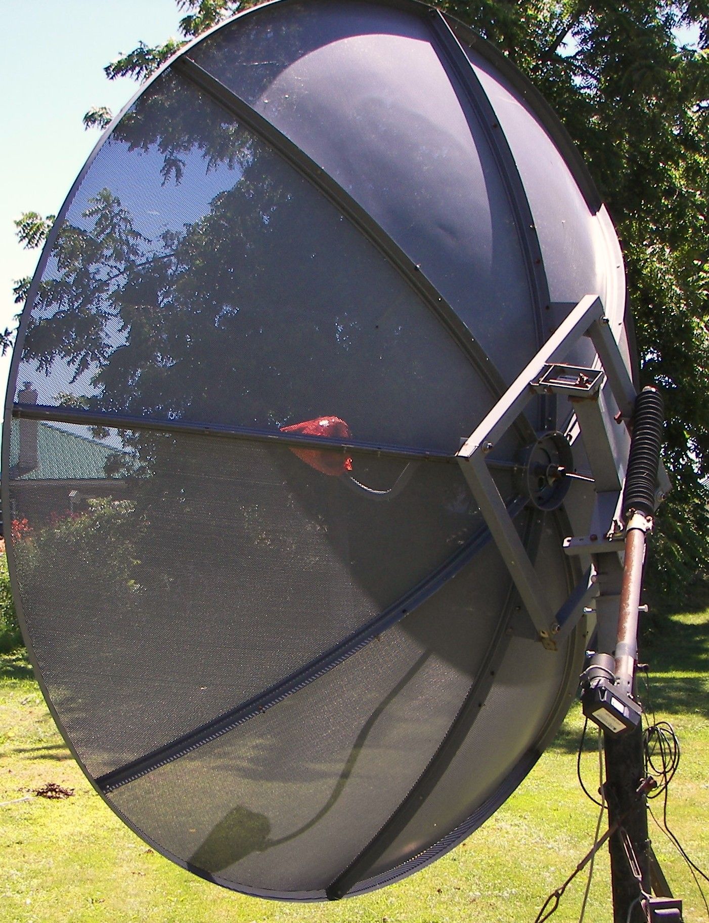

Range of 10' Winegard Pinnacle with 24" actuator,no mods necessary;
100_0471.JPG 100_0472.JPG 139w to,well have no idea,trees/ buildings block most east of 72w

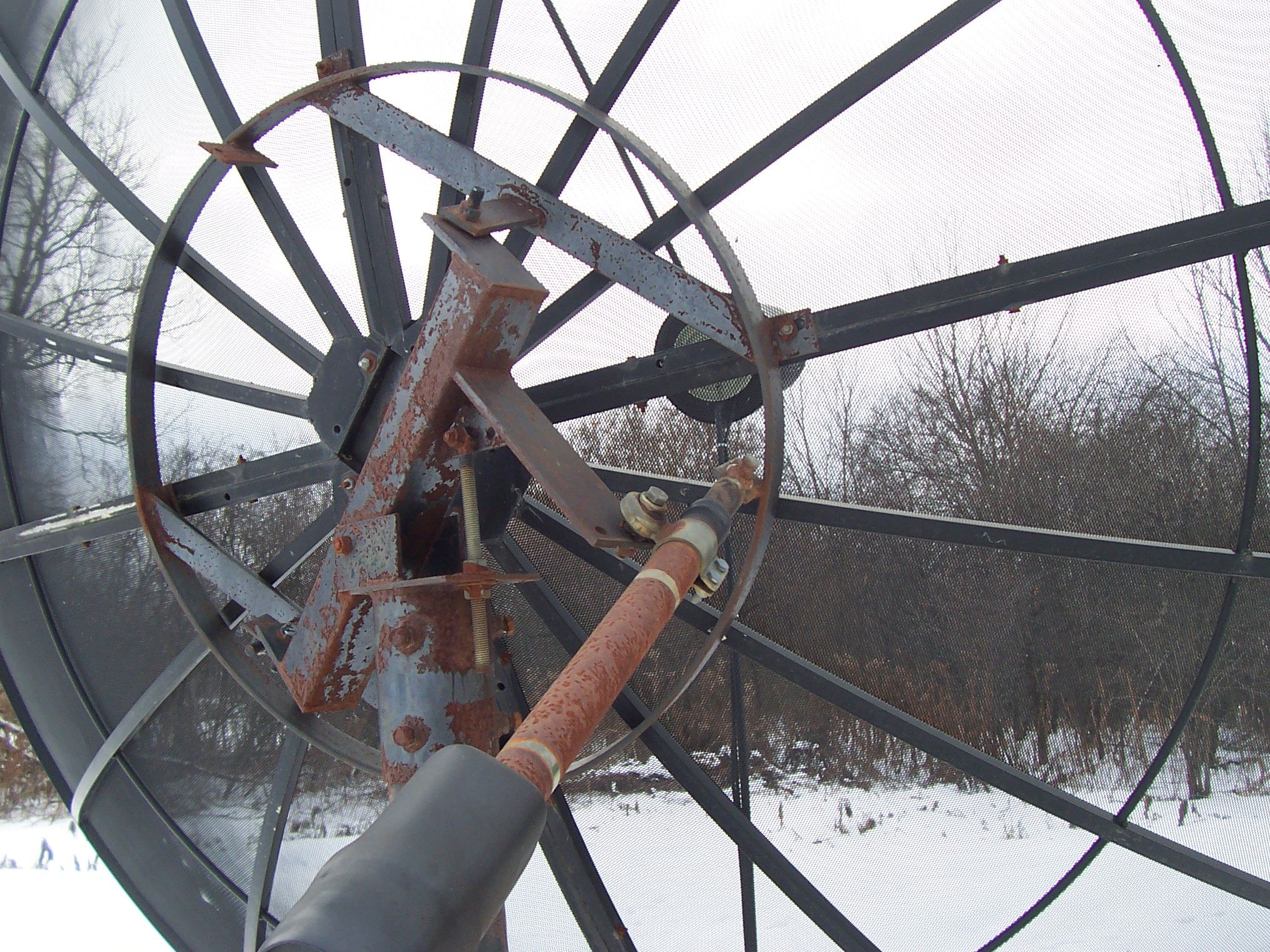

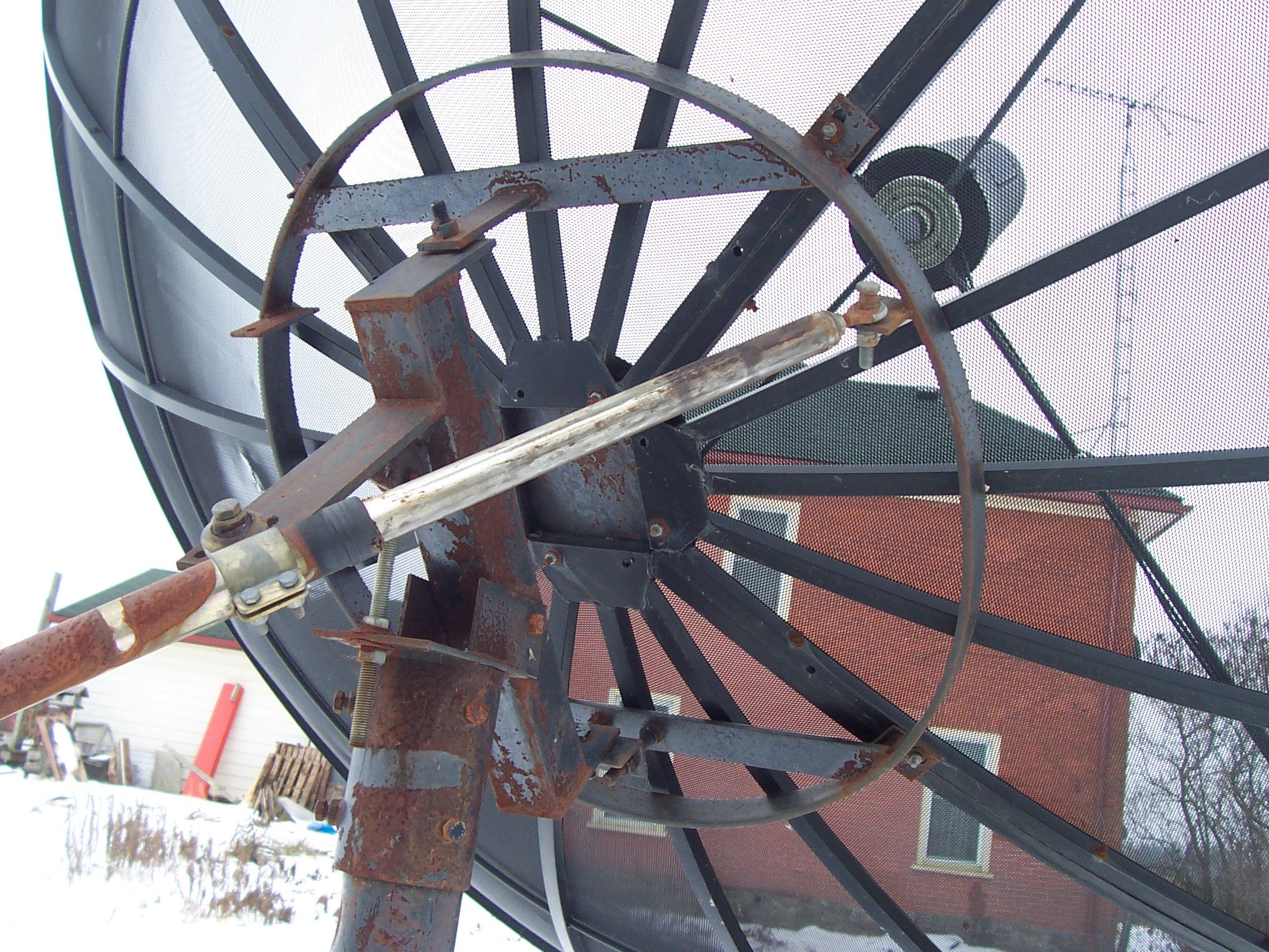

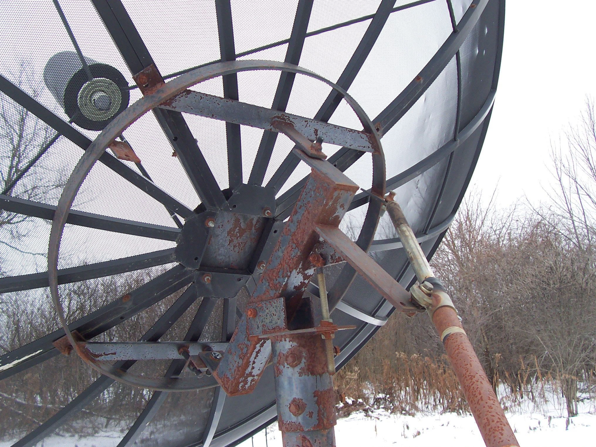

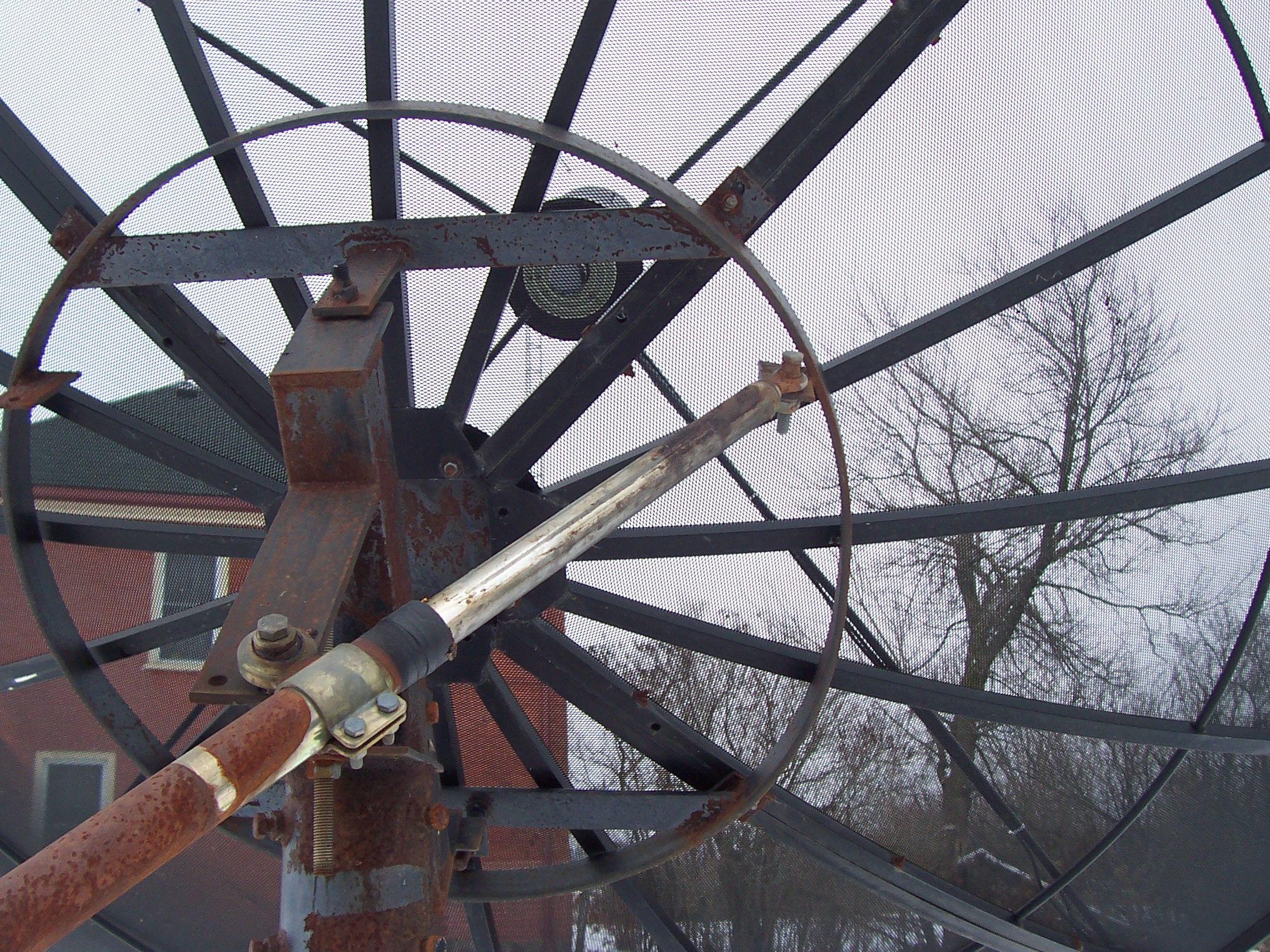

Well I measured the length when fully extended and its about 17" not including the last 1" or two where it attaches. I have included a few pictures of the mount. I think clamping further down on the actuator will work. Just have to see how much is lost on the bottom of the arc. Not much there except reelz.

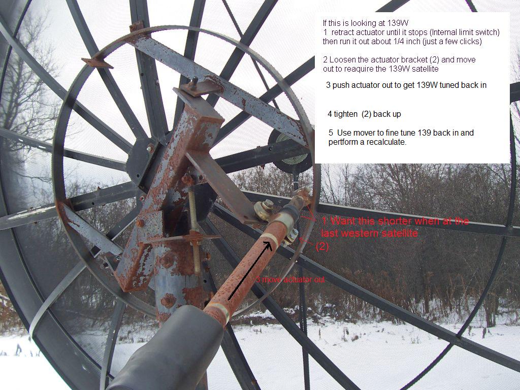

Thanks for all the replies.100_4042.JPG 100_4047.JPG 100_4049.JPG 100_4050.JPG 100_4052.JPG

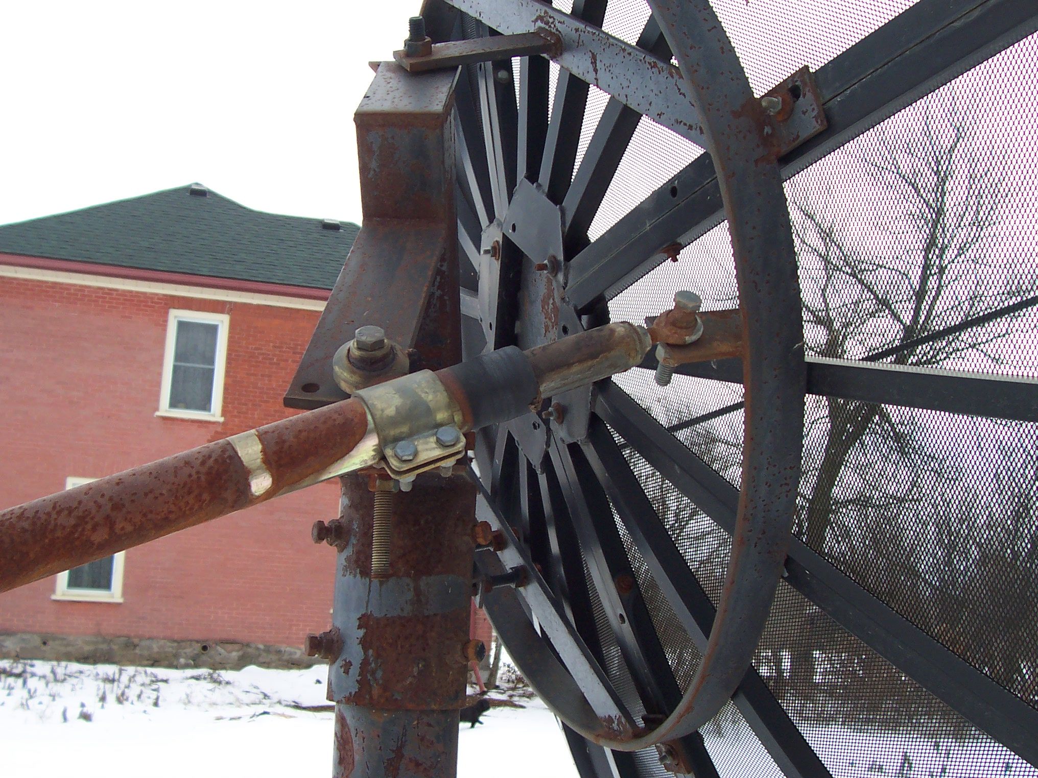

Looks to me like you need to make some MAJOR adjustments to that thing so you can get more travel out of the dish. But before you do anything to it, in the first picture on the left, what satellite are you on and or are you on the West Limit Switch?
Keep in mind here that "most" of these Von Weise actuator WEST limit switches are NOT adjustable so you change that by moving the outer tube in that clamp where the swivel joint is.
Sorry I knew there was something I forgot to do. When almost retracted its pointed at 135W and when a few clicks from fully extended limit 83W.
Great job with the picture FaT Air. It explains what I was trying to say so much better.

Here's a pic of my Unimesh on the West Limit Switch, which is about 15 clicks on the Vbox X West of 139w to allow for peaking that satellite.
I noticed that your polar mounting ring is much larger than mine, which moves the rod end out from the dish mount pivot point. That's going to limit how much of the arc you can get back East, BUT, it will also make for higher counts between satellites so it's a good thing, bad thing deal. That ring on my Unimesh is only 23" in diameter and the one on my Winegard is 26".
But notice that the inner tube on mine is WAY further in than yours. What I do is "carefully" run the actuator all the way to the West limit switch until you get the E2 on the Vbox display. Once that's done, then disconnect the rod end at the dish and then turn that inner tube IN until it bottoms out against the housing inside. Once that is done then turn it BACK OUT about 1.5 to 2 turns so it CAN'T BOTTOM OUT AGAIN WHEN IT'S ON THE WEST LIMIT! You'll likely be about 1/4 inch from bottom on the West limit if you do this correctly. If you don't do this correctly then you might be in deep s**t as I'm not sure what will happen if that inner tube hits the housing BEFORE the West Limit Switch cuts the power to the motor.
Ennywho, once you complete this basic adjustment run the actuator about 15 clicks East then you can work on finding 139W (or your last West satellite) by sliding that tube in the clamp like Phat shows in the other picture. After that you can work back toward each satellite until you get as far East as you want or can go. Then set East Limit Switch a little past that last satellite, which is adjustable from inside the cover on the back end of that Von Weise mover. As others have mentioned though, make sure you don't go out far enough out to get past the flop over point, ie, the inner tube crossing over the upper dish pivot bolt.
