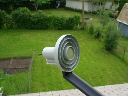

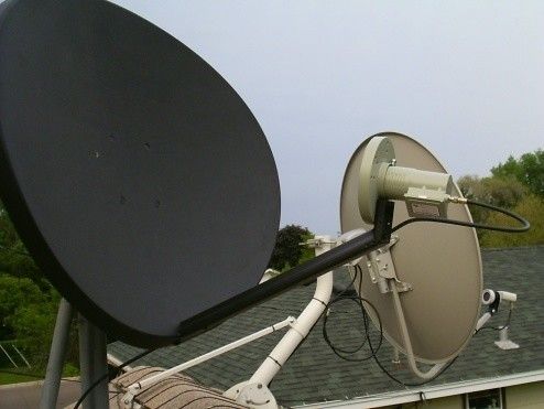

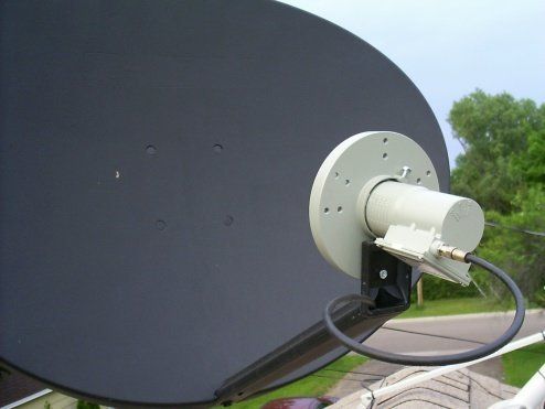

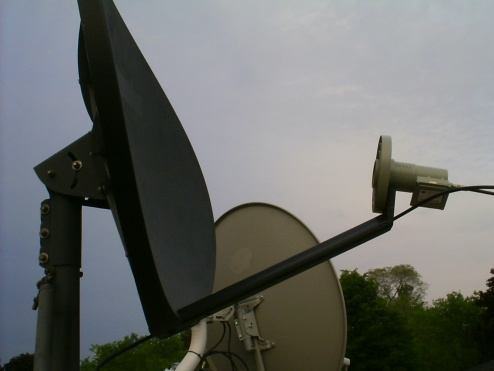

Anyway I received my ASC421 C-BAND LNBF and I could not wait to have try at bagging some C-band action. It was raining for a change (NOT) so I just drilled one hole through the P* LNB mount and with the screws that came with the LNBF I had that C-Band LNBF secured in seconds flat ( I hate rain, it reminds me of home)
So I return to the laboratory and start a blind scan using my trusty Satwork ST 3618 as it has one of the best pictures out there and the on screen quality meter is solid as a rock (low but SOLID)
First thing I noticed is it takes l o n g e r to scan C-band....
Finding nothing after scanning I jump back up to the roof and pick another random satellite (RAINING) Come back to the laboratory again and start another blind scan on my tr...... you know the rest....
BANG! A signal!........another...........another.... Have about 7 in all.
I finished the scan and started changing channels.........

Had a look at the link, looks very similar. But we will have to wait until MrTim tells us what specific type of dish it is intended for, but as I have seen tonight it certainly works on an off-set dish. Cascade will tell you the same. The picture on the box shows a prime focus dish.
Still have a lot of tweaking to do :yes

Before my sigmeter went the way of Voom I noticed that if the scalar ring was as far forward in the LNBF throat as possible it'd give the best sig.
I tried the LNBF about 4 inches behind the scalar ring with an air gap between them and my sig level went crazy.
The only thing I think we really need to work on is the focal distance, a prime-focus LNBF is miles away from the dish compared to a small offset and that makes a huge difference.
