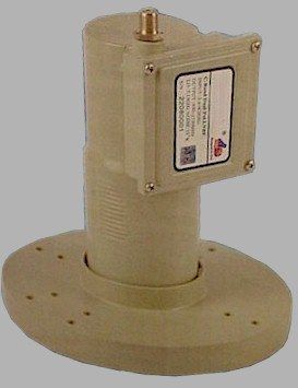

I'm thinking that for offset dishes, no scaler rings might be the way to go, as suggested. But how to remove it? Pete, are yours removable on the DMS ASC421 C-LNBF's? On the one old C-band lnb I have here, short of doing some irreversable damage with some power tools I don't see how the scaler rings could come off...
Edit: I think I found the answer to my own question ;) Found a picture of the ASC421, and the scaler ring sure looks removable:
Yes the ring is removable, and the 36" dish I have I got from AdventistSat.com/SatelliteAV I have had no trouble with it, the only markings on it are SatAV.

Found a place that sells 120cm dishes for $264.83 SHIPPED (Azure Shine F Ku-Band/C-Band Dish - 1.2 meter (Baja Beach) offset). The specs are pretty near identacle to the Fortec, except for better Aperture Efficiency. I already ordered the DMS ASC421 C-LNBF from Pete. I'm planning on trying the lnb without the scaler rings in a dual-lnb clamp so I'll have Ku and C-band on the same dish :D Now if only I had a better Ku lnb to go on this new setup... *kicks the old .6dB*

40" with ASC 421 C-Band LNBF without scalar ring........

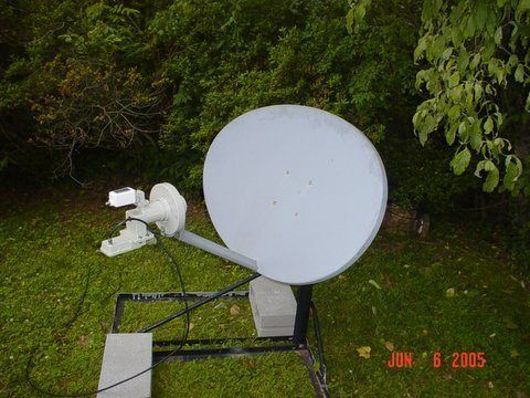

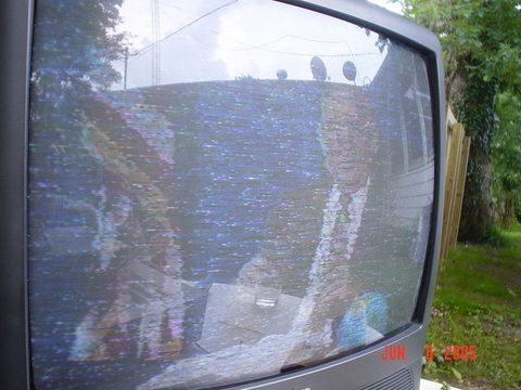

Tried a 21x28 oval dish and a Chaparral C/Ku LNBF this afternoon.
Using the C100 analog receiver, I was able to see numerous channels on birds from AMC3 to Galaxy 12. I swung back to AMC3, tweaked it for vertical (could see Doc on TP20 but VERY snowy), did a blind scan with the Pansat 2500 and came up high and dry. It started looking stormy so I will try again tomorrow. Also, a better C-Band LNB should be here as well.
On Galaxy 4, I had color and audio on "World Harvest TV", analog of course.....Also noticed some weird goings on on TP1 of IA-5. It was scrambled, but intelligible!
See photoz below...
On a final note, an analog receiver is invaluable for this experiment.
