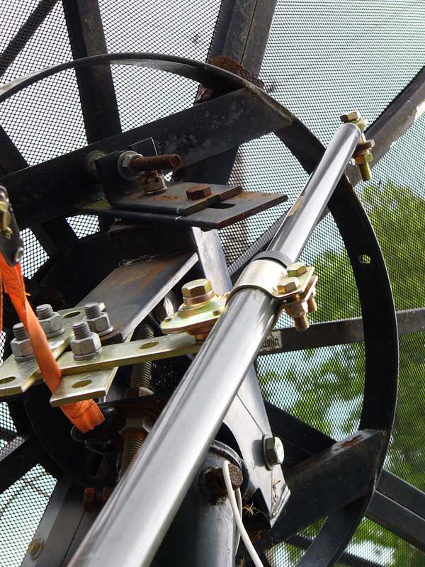

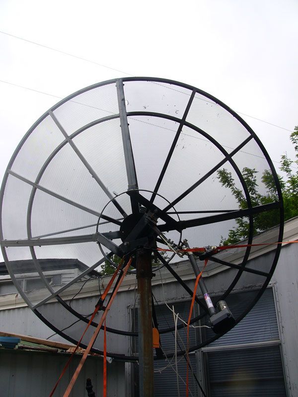

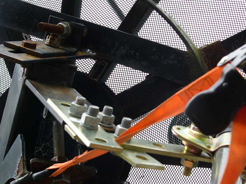

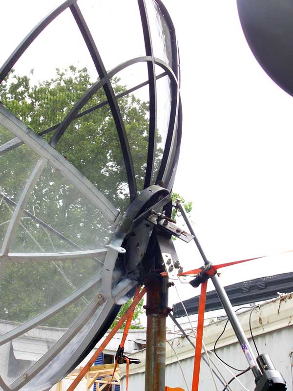

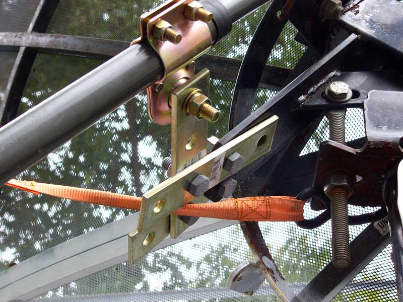

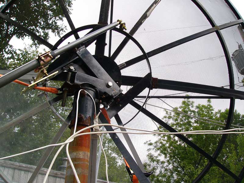

Tracking great on a temp mount with limited space.
I had to extend the mounting point for the actuator, and go from 18" to 24", but I'm now tracking from 45º - 133º!
What I can't believe is that I can actually pull signal with almost half of the dish blocked at 133ºw. I can get the Classic Arts @ 40% Q on the Azbox (nothing else). At 131ºw with about 1/3 of the dish blocked I pull the 8psk signals at 51%.
Next I might put the 18" actuator on my 84e and get rid of that SG6000!
