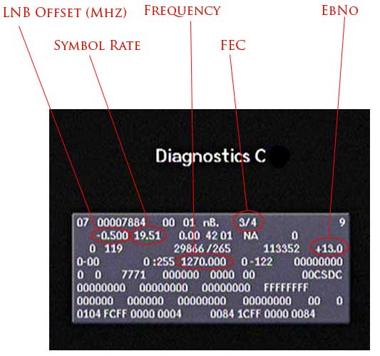

I know that some of this information used to be readily available on the internet, but one of the major sites that had it, is now defunct. You can get their pages out of the wayback machine at the internet archive, but that's a bit of a PITA. So, I figured I'd grab the screen shots and just slap the stuff right in the image. I'm also thinking about making some flash type tutorials about them maybe with videos captured off my HTPC and my 922.
But for now, I thought I'd get started with just static text in the image.
If anybody has some feedback or would like to see other items marked, let me know. There's a lot more info on this screen, I just figured that I'd mark the more interesting of it.
For now, presenting... Diagnostic Screen C

mainly I was trying to make them a little more user friendly/easier to interpret..than the originals.
how bout we convert them to PDF.. or I can make the flash/jpeg versions

I have the stuff from the wayback machine. I was just trying to make the screens easier to interpret/understand. That's why, for now, I just drew right on the screen shot.
I can host the pages on my server, but figured that since we now have a 4dtv section here, we might include them for forum users
