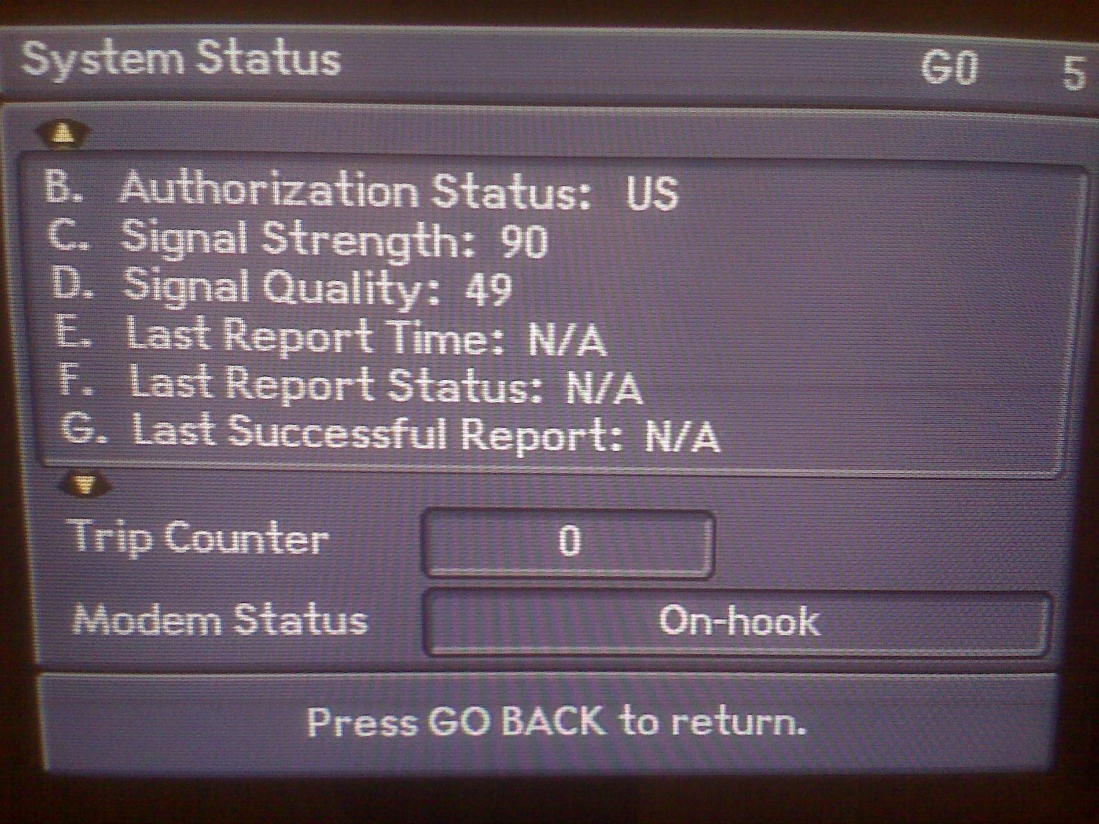

I heard that some people see a channel listing in their status screen when they are remapping, and it increses, and it looks like the book that came with the 905 has that info also.. but all I see is a Trip that is at 0.. no channel listings. I am posting a picture of what my screen shows.. Also, my reciever didn't download the new W5 sat into memory, either.

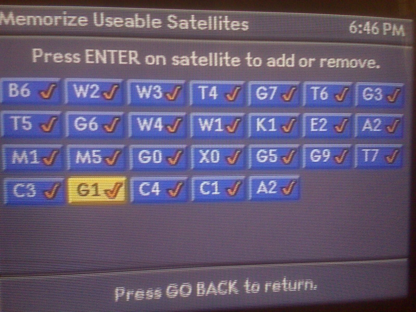

I was able to submit a rehit.. and I wait 20 minutes on G1 - 3 and the trip counter didn't change.. and I also changed over to G1 167, and rehit again.. it still didn't take on my reciever. I am posting a picture from my "Memorize Usable Satellites" screen. I noticed that the 922 had a lot more usable satellites than this 905 had..
Inno,
Thanks forshowing me that post!. There is some good info in there.. seems like the 905 is the red-headed step child in the 4DTV world... When I have called providers for help, most say "I don't know anything about that box, it was before my time".

Post a Pic of the Diag Screen
Option, 6, 5

[FONT=Verdana, Arial, Helvetica, sans-serif][FONT=Verdana, Arial, Helvetica, sans-serif]Why does my receiver skip over channels?
[/FONT]
[/FONT]When new channels are added they need to be mapped into your receivers memory. Do this by going to a Digicipher channel such as G1-3. Pull up the System Status screen(options, 6, 5) and check the channels in the bottom right corner. You should see the channel count go up within a few minutes if not, unplug the receiver for 20 seconds and try again. If the channels still are not changing after that check to see if the receivers memory is full. You can do that by pressing Options, 6, 0, 5. That will bring up a “Diagnostics A” screen. Press the right arrow key until you see “Diagnostics G”. On the top row fifth column to the right you will see a four digit code if it is 1920 your memory is full and you will have to do a master reset and re-program your receiver. To do a master reset you will need to press Options, 6, 7, 7, 8, 7 and then enter to confirm the reset.
