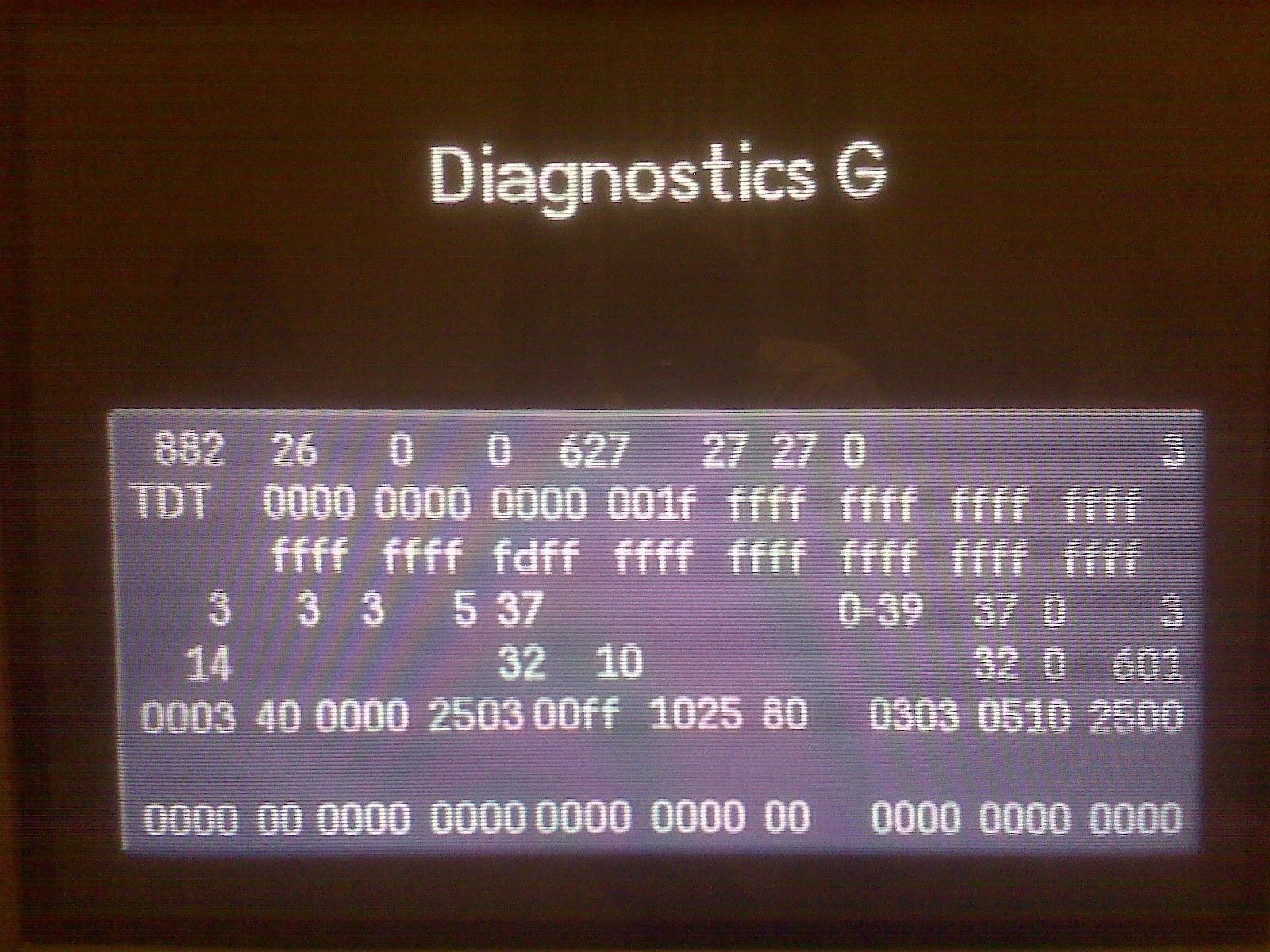

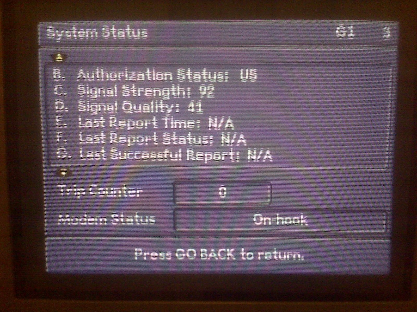

Here is a copy of my System Status screen (Options, 6, 4 on the 905.. Opt 6,5 is the sleep timer).. I saw on some site where the 905 doesn't have a channels box to look at. I've been on G1 3 for the past coouple of days... did the unplug trick, master reset, all of that and went back there... and it came back up with the same channels as before.
Also I have included the Diagnostics G screen My TDT count is at 882, so I shuld be good there.:

I just did a master reset again.. When I booted back up, I didn't have G1-3 to choose from.. In fact, my channel listing just showed ch 255... so I had to do the following
1. Set usable satellites.. (Choose all on the list)
2. Tuned the 905 to G1 channel 255 (only option)...red lite on box
3. manually went in and tuned the frequency in
4. options 6-7-7-8-1
5. set for 1390 freq, left polarity, s/r 19510 fec 3/4 and hit tune
got the green light now... so it should be DL'ing the channel maps..
I tried Authorization Reset also earilier... I just sat there saying "Waiting for Authorization stream" or something like that..
Will keep it here to see if I get anything different as far as maps
