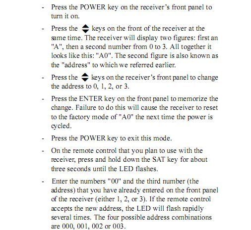

D Dishman Dan SatelliteGuys Pro Original poster Jun 22, 2008 1,549 0 N/A Apr 9, 2011 #1 How do you set up the remote so that when you have more than one 4DTV receiver it will only run one receiver and not interfere with the other?
T tvropro On Vacation Mar 9, 2007 6,872 0 Apr 9, 2011 #2 Here you go Attachments dsr codes.jpg 55 KB · Views: 270
D Dishman Dan SatelliteGuys Pro Original poster Jun 22, 2008 1,549 0 N/A Apr 9, 2011 #3 tvropro said: Here you go Click to expand... Got it! Thanks very much!!
