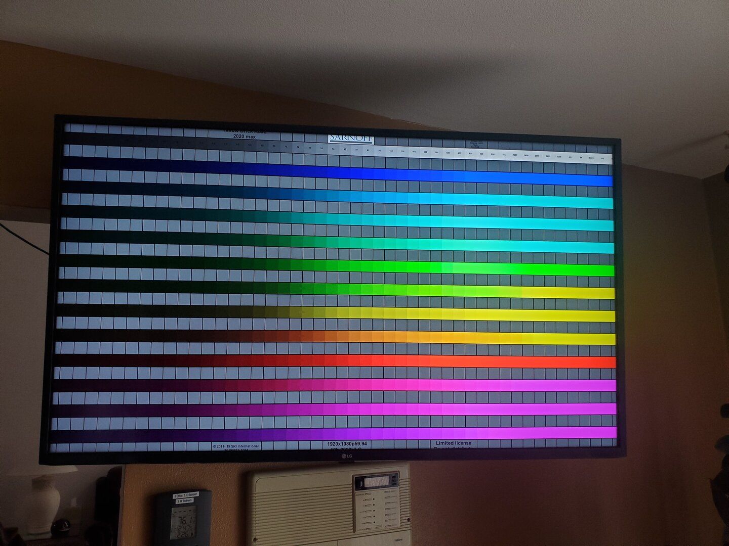

I am trying to watch channel 540-04 Olympic program. Why do I get this pic? Tried changing channels, reset TV and H3, and a different HDMI input on the TV. I have watched 4K HDR before and it worked.
  • Sad
Reactions: TheKrell
That is the test broadcast that has been on this channel for a few weeks. It will be there when there is no programming being broadcast. There is no Olympic programming being shown. The 04 channel was dedicated to the Olympics and they have not changed the wording in the guide. The Winter Olympics is forthcoming and they will probably use the channel then.
