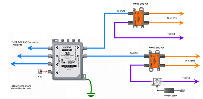

And last thing, I was thinking of maybe getting a second H3 to replace the joey if it is indeed the problem here with the above two issues. I've got the hybrid 1000.2 eastern lnb and the solo hub right now. I know I need a duo hub, but not sure if I need anything else as well. On top of that, I forgot about what changed here with DIRT, so how would I go about contacting them to activate the new receiver? I don't use facebook/twitter but they've always been way more competent than if I call dish directly.
You need more than a duo hub. You need a 42 Switch and you need to change the Eastern Arc Hybrid LNBF to an Eastern Arc DPP LNBF with 2 cables running to the switch
Does the DPP fit in the same way as the Hybrid, or is it angled differently, meaning I would need to re-align the dish itself again?
No, it's the same, unless you have a slimline, meaning a tinier LNB - which are pretty new still. Then you'd need a new LNB Bracket.
