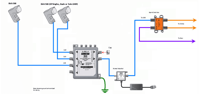

I did an upgrade for a guy that has 3 1-Meter Dishes pointed at the WA Sats. You can do that with the EA. So, you'd run the lines to a 42 Switch.
Are you talking a DPH42 switch? That can be done too, if you say so. But IMHO it's overkill for a H2. Unless he's planning on upgrading to the H3, the DPP44 is probably cheaper. In fact, the DPP33 is cheaper still if you can find one. (I have an unused DPP33 if you want it.)
