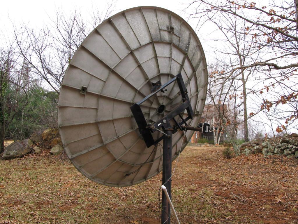

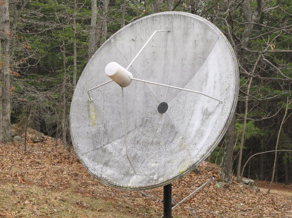

Ok guys I have a choice here.a old channelmaster 10 footer which the lady said was around 30 years old.I could also get a 8ft at saduon for 289 but the shipping is killer around 200 beans but the 6 footer doesn't have high shipping.my question becomes am I gonna miss a lot with the six footer.the 10 footer I'm gonna have to ride 8 hours there and back to get here is pics of the 10 footer

If the 10 footer's free and not warped I would go with that. I read all the time that channel master makes a great dish.
A 10 footer is going to pick up some hard to get channels, DVB-S2 was spotty on my 8 1/2 foot dish, but came in strong on a 10 footer.
The dish sadoun sells is made out of steel, anything steel is going to rust over time.
That is a real early channel master, never seen one with the feed arms like that. Look for a data plate inscribed on the dish, might be able to guess its exact date.
That dish also comes apart, so if it is warped, you might be able to make it un-warped.
That dish is real dirty, but some pressure washing and scrubbing will make it look like new.
ALSO, another thing to check, if the holes in the mesh are large enough, it won't get Ku or be a real bad performer on Ku.
They want a hundred bucks for it and id have to drive to check on condition.thinking maybe start with the six or eight from sadoun. Is there gonna be a big difference between the six and eight? Would I be able to find parts for that 10 footer.if any one is from Va some help would be good. Lol
I'm an old timer and seen those before. It a mid 80's style. I believe it is fiberglass that dish. If the parabolic is good you can clean it up and paint it and have a nice dish for c band. Ku may not play all that well depending on the screening used. But these days toss up a good 90cm offset and it will out perform it on ku.

Go for the 10 foot dish and hold out for free with the wiring. I picked up one of those about 15 years ago with a friend of mine. It comes apart in quarters and is a two man job to take down and take apart. You'll want to take it apart because it'll become airborne if you don't AND it'll get you a ticket for too wide of a load. We learned that lesson the hard way. The dish holds its shape well but it's still a good idea to take a few minutes and look for obvious abnormalities. It's fiberglass if I remember correctly. I gave it to the guy I picked it up with and he had it in his yard for a few years before parting with it.

Why don't you search the forum for threads dealing with the 8' and 10' Channelmaster molded dishes?
One or two guys have restored those beauties by repainting them (when they looked trashed) and brought 'em back to like-new condition.
Do an Advanced Search on "channel master" by "McGuyver", and you'll find a lot of help.
His is the 8' model (notice how the bent LNB arms mount further out toward the edge of the dish).
I think ACradio has a 10' Channel Master, so search for his threads, too.
Pretty sure he commented on what he thought of the dish (he's got some 8'ers, too)
Unless my memory is failing me, I'd take some help, and go get the CM & pole.
Then, after a power wash for the dish, and some rust-inhibiting paint for the mount, you'll be set for the next 20 years! ;)
