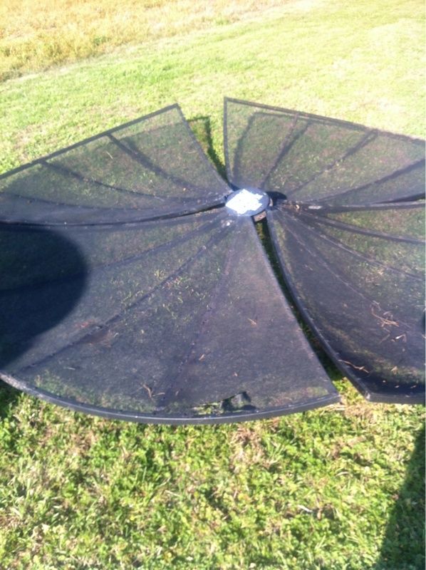

Went and got it and it's a 10 footer
Sami makes it and it has one tear spot in the mesh near the end. What I like is the mount is solid. Dee don't you have a 10 foot mesh made by Sami?
