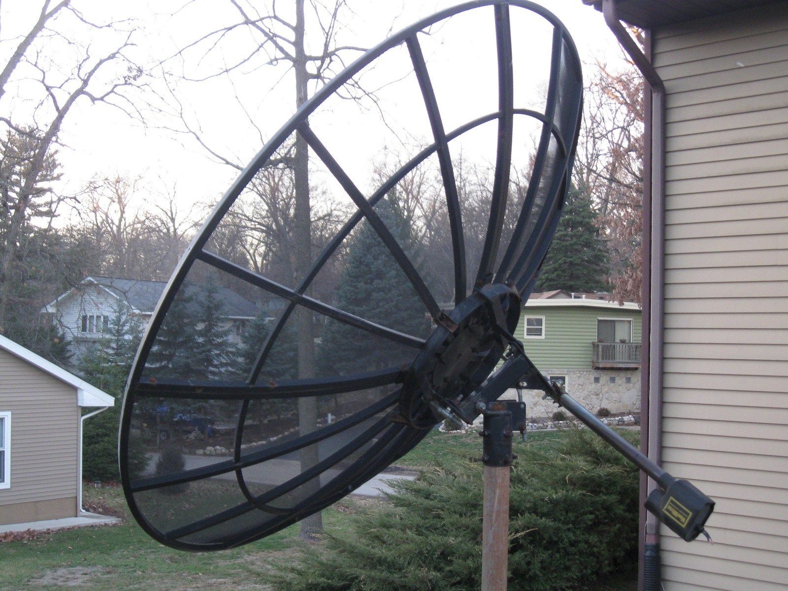

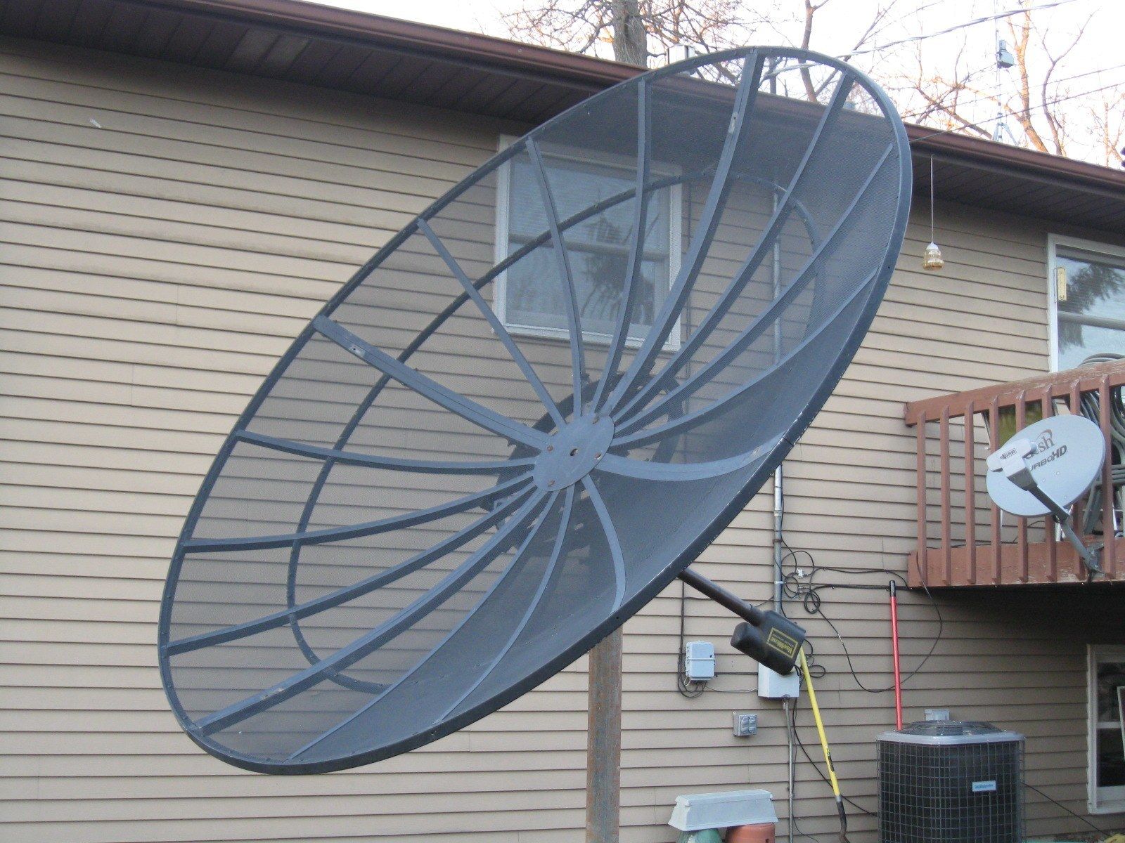

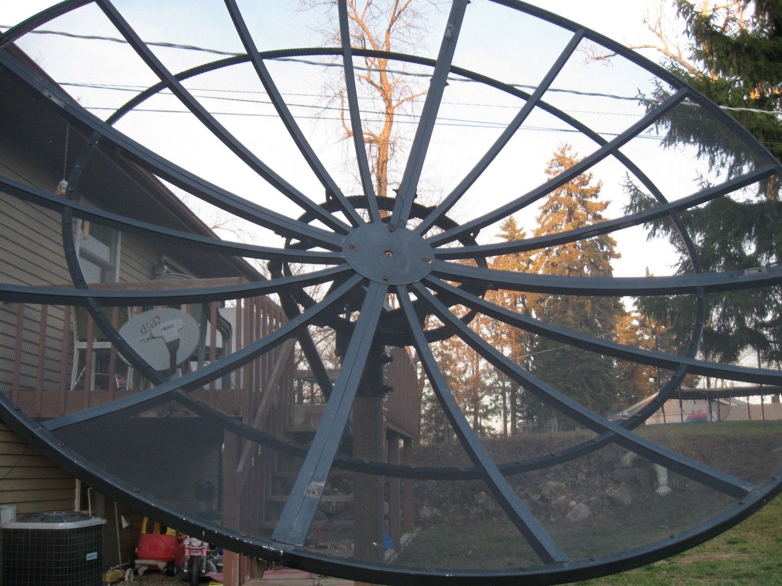

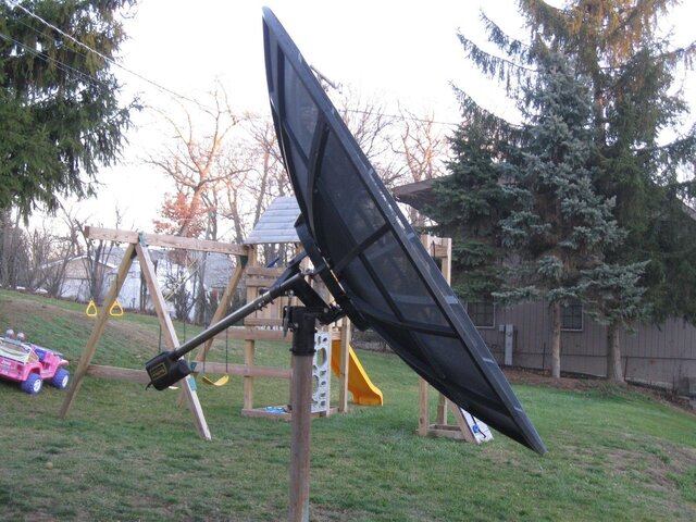

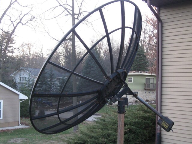

Picked up this 7.5' mesh BUD locally.
Dug a 12" diameter hole, 50" deep and used 720 pounds of Quickrete mix to secure a 10', schedule 40, 3" galvanized pipe. I picked the pipe up locally from a well drilling/plumbing company for $10, cut to size. After curing, then removing the bracing and checking with a 4' level it is, to my surprise, perfectly plumb.
Any way, I have the dish mounted and I'm ready to set elevation, declination and f/d on the lnb. The only problem is I'm not sure what brand dish this is. From what I can tell it looks like a Unimesh. I see no markings, stampings or scribing on the dish itself.
Can anyone ID this dish so that I can find the f/d setting?
7.5' mesh dish 001.JPG7.5' mesh dish 002.JPG7.5' mesh dish 003.JPG7.5' mesh dish 004.JPG
