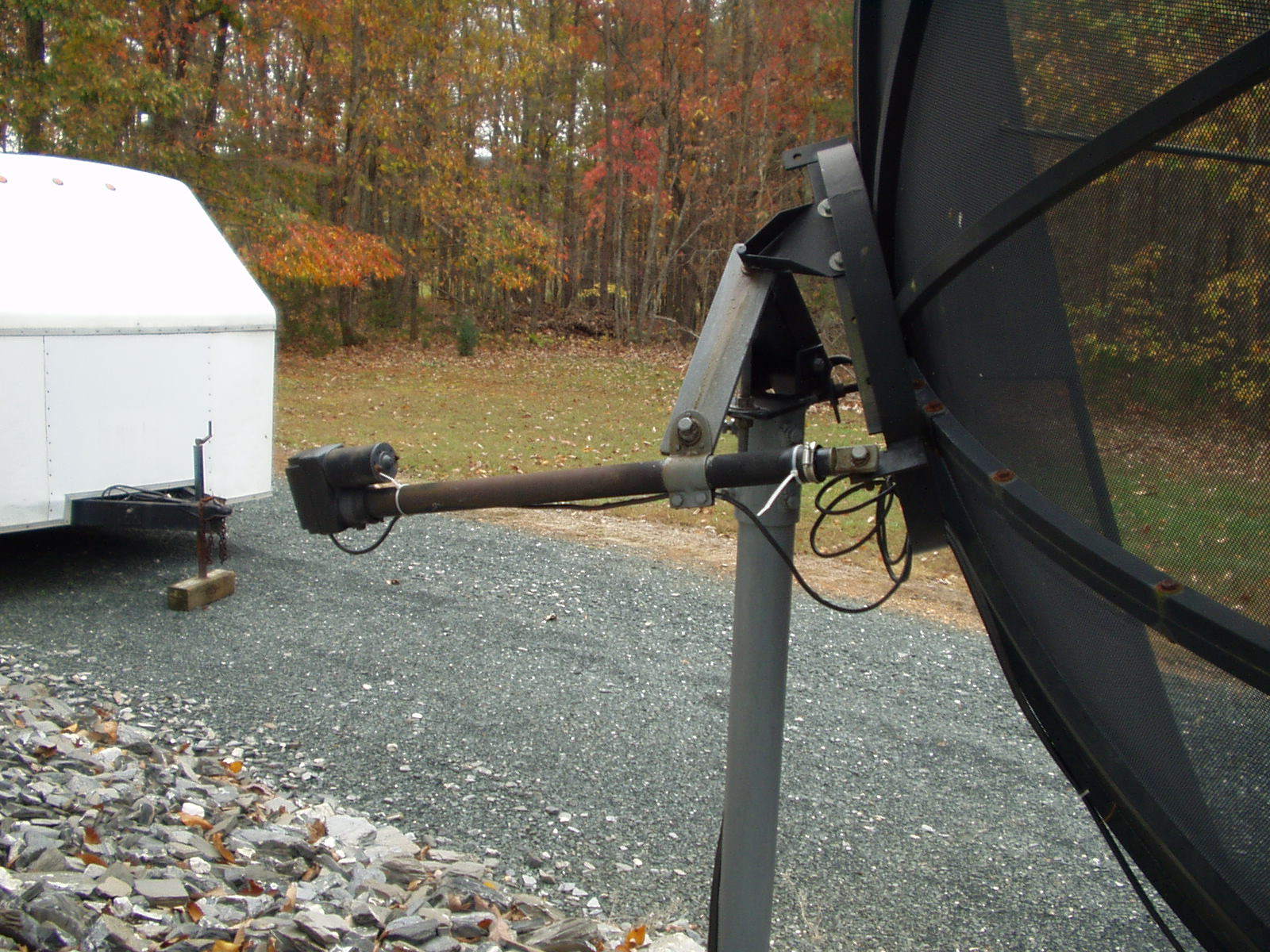

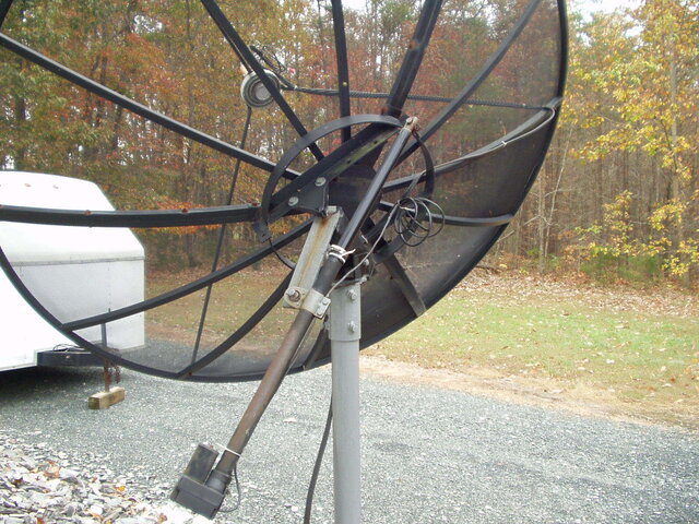

BTW, my SAMI dish is also a 7.5 footer with a 24" SuperJack linear actuator on it mounted on the west side like yours. I'm looking at 139w to 37w and probably could get to 30w if the trees on my property were shorter.
The linear actuators I've seen (Von Weise and SuperJack) have the limit switches inside the cover on the end and are the adjustable cam type. If this dish was originally setup and working before you got it, then it's likely that the limits are already set. Just be careful though as if you get the polarity reversed running the motor in the opposite direction than intended, then the limit switch may not stop it. This is especially critical when it's running in the IN direction as if the inner tube runs out of travel it may hork up some stuff.
