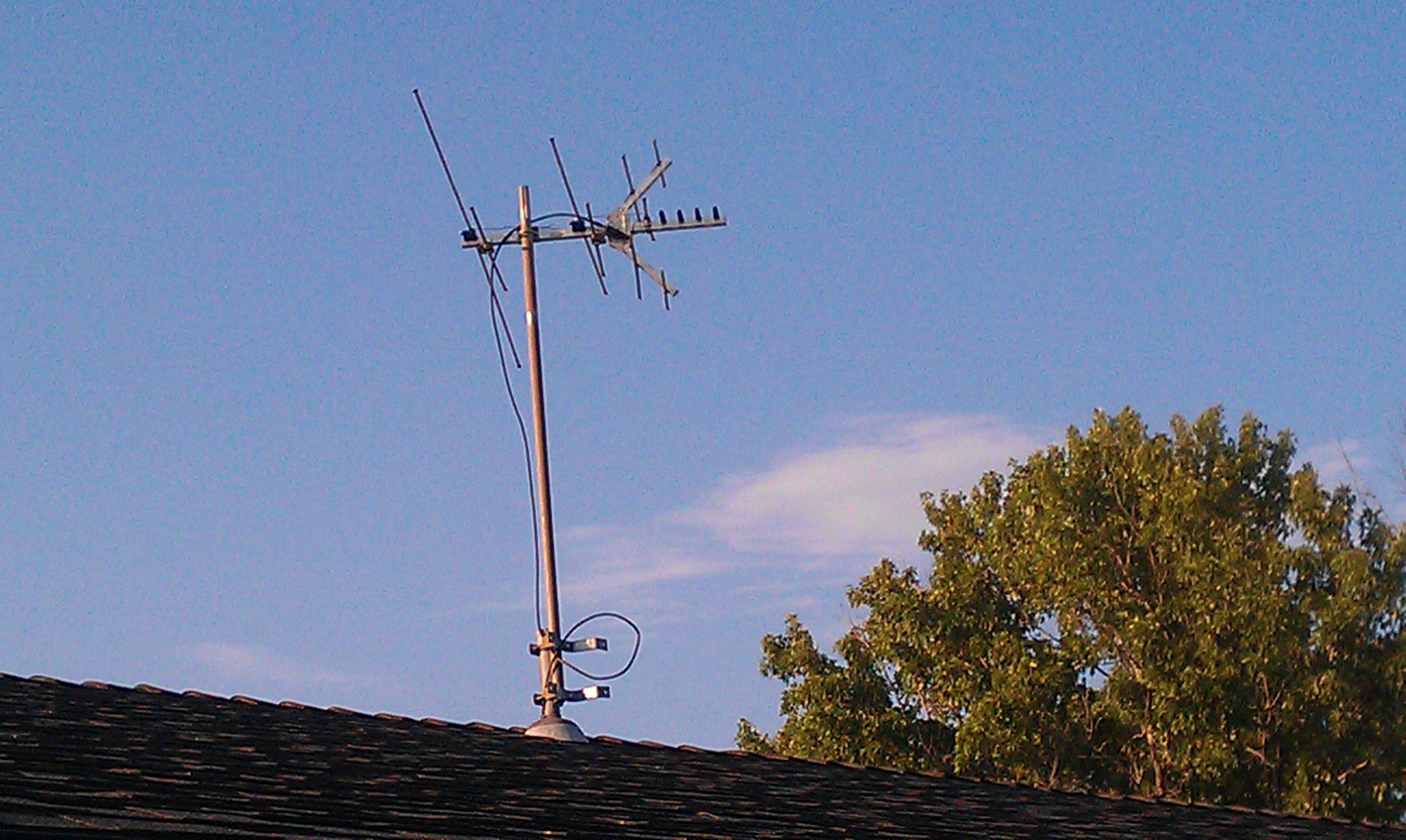

The antenna the 722k is connected to is a small all channel antenna, probably a Radio Shack or similar (pic below) that was in the attic when we moved in 11 years ago.
I had to move it outside to pick up RF 39 which is about 75 degrees left of the beam of the antenna, it is still irregular, but only 2.5 miles away.
