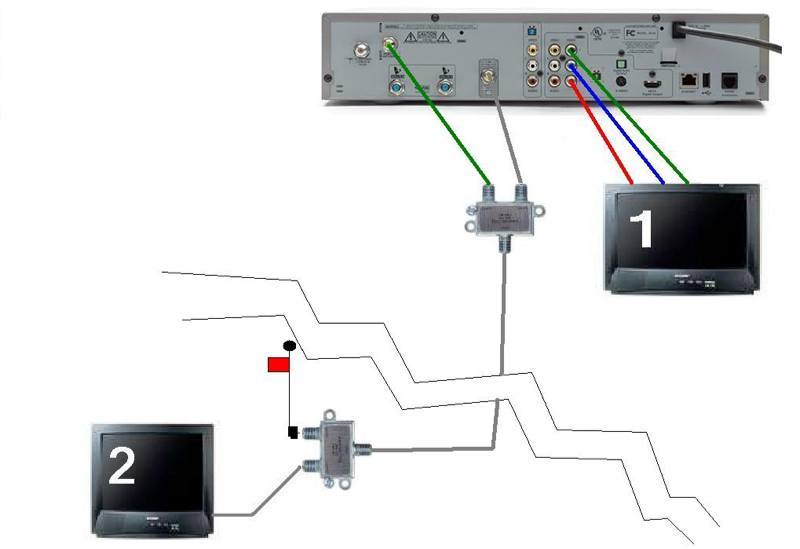

If you have a few cable jumpers or can make them and two spliter/combines lying around..
Make 3 short jumpers.
Run one off uhf ant out on back of rec
Run one off tv2 out on back of receiver
Both going into the "outs" on a spliter.
Run the 3rd jumper off the "in" off the spliter to the uhf/vhf port on the dipexor.
At your tv2 room you need to split the signals back out. Run a cable off the wall plate into the "in on. The spliter. Put the uhf ant that was on the back of your 722 on one of the "outs" on your 2nd spliter. Then other "out" run a cable to the tv.
In some cases this works great. If it comes in a little fuzzy you may have to just run a cable all the way from room to room like stated above.

the splitter trick is something i roll to customers homes to do about once per week. this fixes the problem permanently. if you cant do it, just call support and get a tech sent over. takes about 5 minutes to do.
I used a trick someone here suggested and used a couple of splitters to feed both the small antenna and my OTA antenna into the 722 coax input. Works great.
This works great with the Home Distribution port as well (can also use with the diplexer.)
