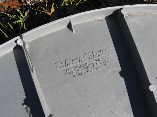

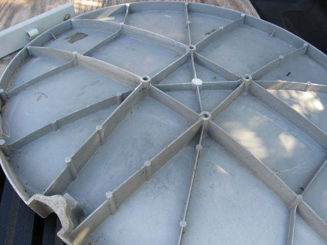

I didn't get much but I did get a partial set up and was wondering where I could locate the remaining parts I need to get this thing working.
I need a mount and the four (4) bolts that hold it together and the half moon top thingy (techie term) that holds the LNB on.
Anyone have parts source for these items?

It is the 129 model with the D*net bracket for 110/119 and 2 unlabeled legacy LNB's.
The reflector is a CM 75e.
The mount pipe is OD 2 1/4" IIRC
It's the LNB setup that different (or in this case missing)

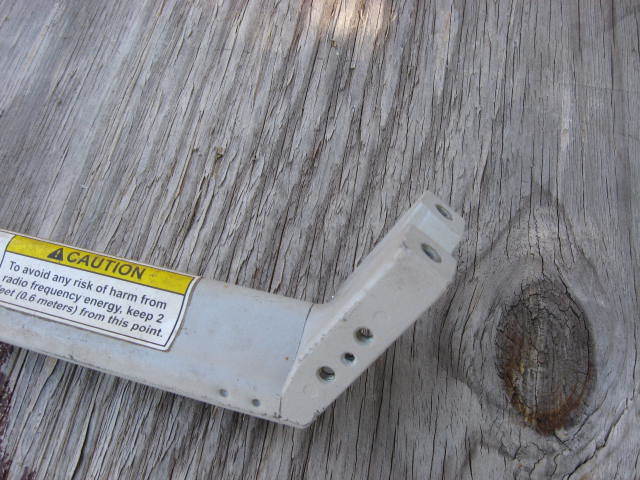

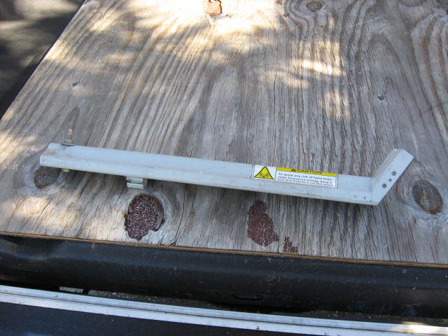

I am beginning to question if the length of the arm I got is correct. When I rescued the dish from the pile of other size dishes, the one and only arm there was the one I picked up.
Was it the correct one. I don't know. Does anyone what the length arm a 75e dish uses?
Thanks
Does it still not have a sticker on it saying for 75e only? The 75e arm is 19 3/8 inches long if measured on the bottom flat side of the arm.
Nope. No sticker. It does have the numbers 3040979-04 stamped in the piece that supports the LNB.
It measured out 19 1/16 inches. Close enough to be the one?
The old arm I have just says 3040979 and has a 5S in the corner and a sticker that says for 75e only and something about the feedhorn type. So I would guess you have the right one
