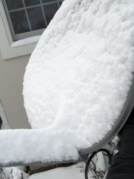

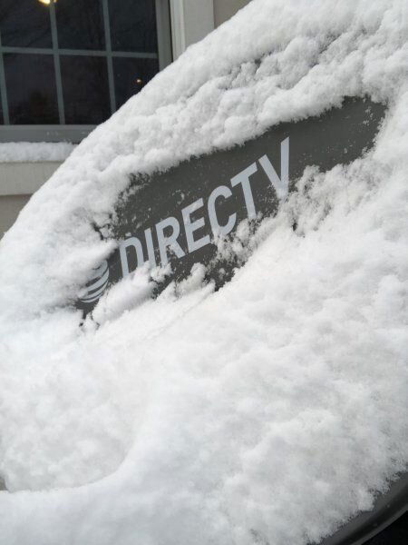

Problem ticket opened
771 this morning, after a thorough investigation it was determined my dish was blocked by some white stuff that fell on the first day of spring :(
Issue was cleared with a good swipe of the hand :)
Problem ticket closed
Thread makes me think of what issues I would have been dealing with if the dish was mounted on the roof, I am glad to have it ground level, just not so visually pleasing but oh well. This is the second time this has happened.
Ahh yes, the dreaded Wet Snow ....
Thats about the Only time I ever have an issue, when the wet snow comes and we have a lot of it.
I've had the dish covered and thought, no way will I have a signal, but I did .... as long as its not wet ....
I'm gonna hope your on the North side of the USA !
Yup, North East, it actually happened twice, second time some channels worked but most didn't. Since the dish is easily accessible it's a quick fix. If it wasn't this time around the sun would have melted it by early morning anyway. Prior storm no way, was too much snow and still was cold during the day.
